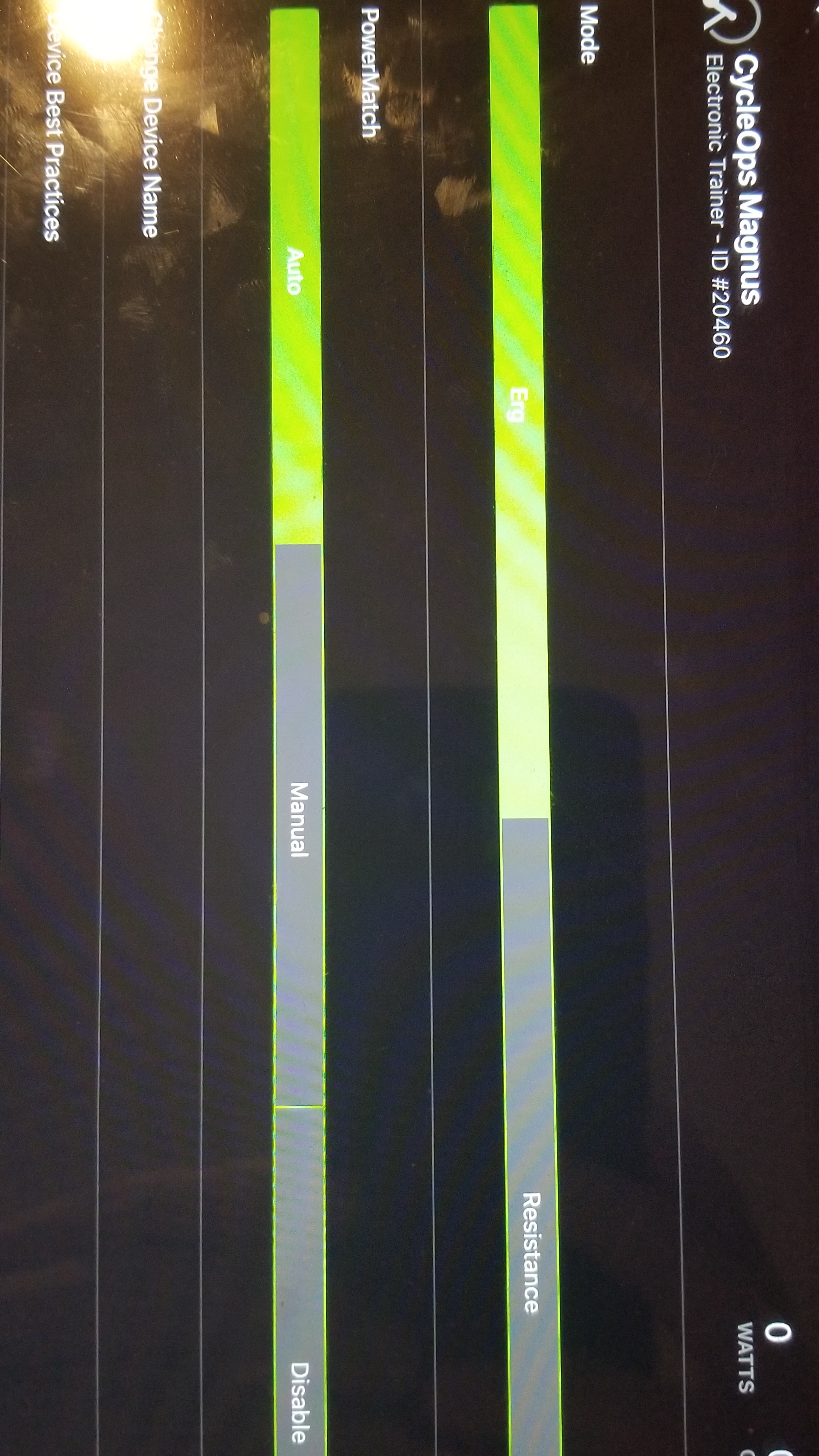

Thanks for the replies. On my iPad it is showing ERG mode is selected.20181003_175242

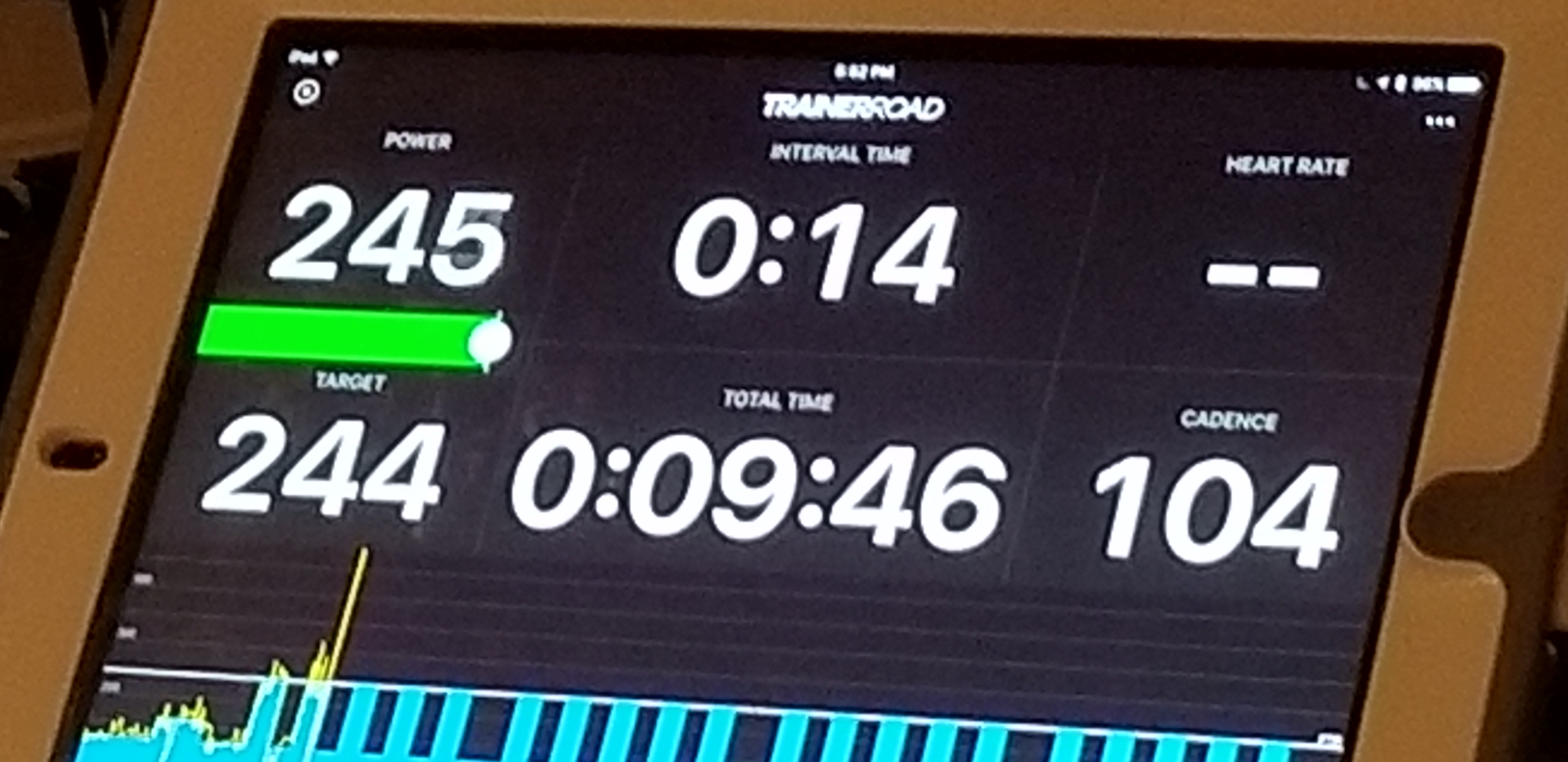

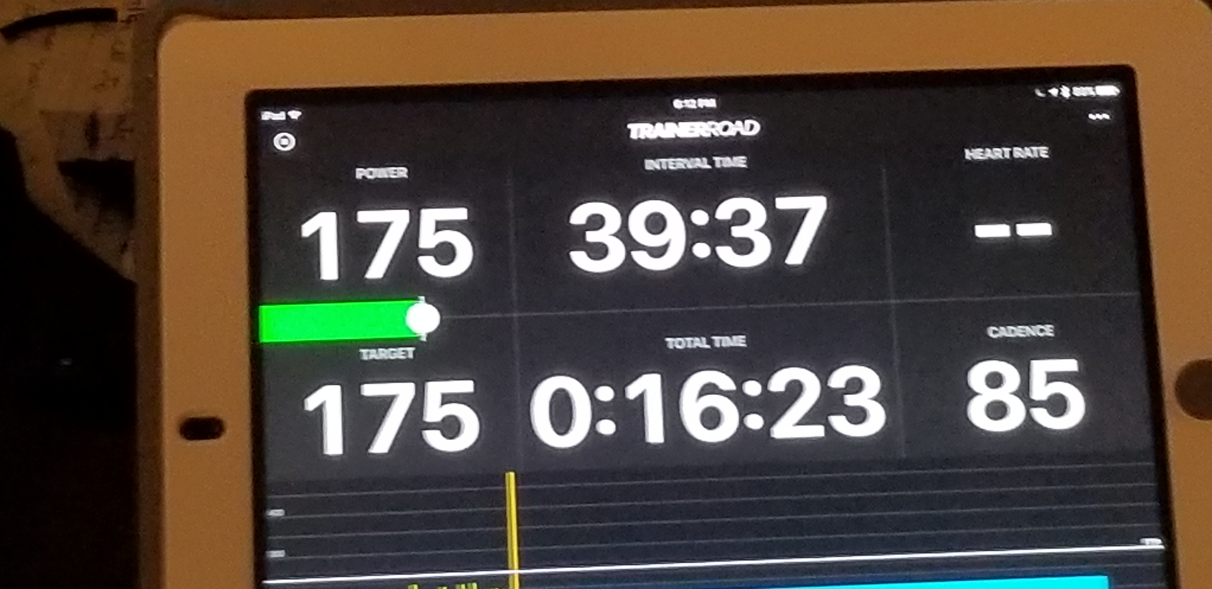

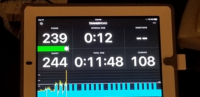

!(upload://gUpUnGk9DtjIbcMGSCks0xUGipG.jpeg) 20181003_173140 I had my daughter take some pictures while I did some riding. Before the ride I had the tire pumped to 115 psi. The Magnus sets the tension on the wheel by turning the yellow knob. You turn it until it clicks, kind of like a gas cap on your car. The first two pictures are an FTP effort in 50/12. The third pictures shows ERG mode selected. The last picture is an endurance effort in 50/11. I use a fan for cooling. I plug an ant+ wahoo dongle into the iPad. Thanks for all the help!
First up do a restart of your iPad. There’s a chance some other app has taken control and even though TR claims it’s in erg mode it doesn’t look like it.
Second it appears you aren’t collecting heart rate so ditch the ant+ and use Bluetooth instead. Or if you are insistent on using the ant+ make sure the Bluetooth is turned off on your iPad.
