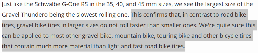

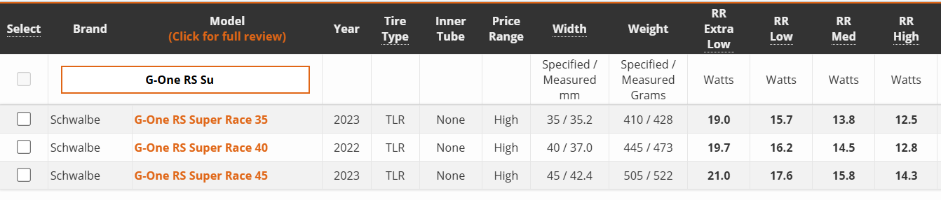

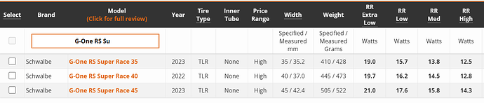

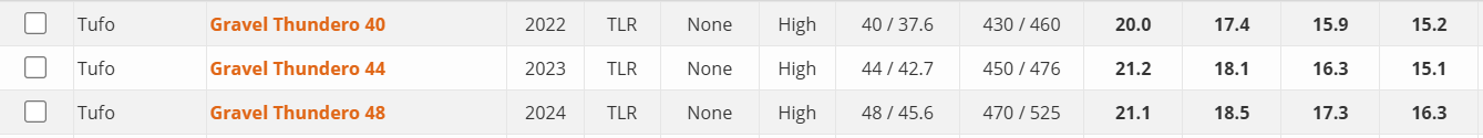

While I agree that in most cases (or all relevant cases) this is true…I run 45mm Terra Speeds now after having run 40mm with no intention of going back down in size… There is most certainly “data” that suggests exactly that a 40mm is faster rolling than a 45mm and it’s a source that this thread consistently holds up as useful for “directional understanding”.
I’m not trying to suggest this is anything groundbreaking, but comments like those above are definitely misleading because you’re cherry picking data to make an absolute statement when this is definitely very muddy.
Again, no one is doing this…there are literally dozens (hundreds?) of posts and links all containing equivocations.
