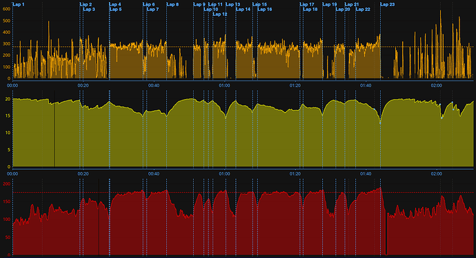

I do 600-900TSS/wk. I try to rise my FTP and VO2max now (cuz I lost some after a surgery and bike break). So I do vo2max intervals on Tue, and then FTP on Thu - I try to do my hilly ride (50-60km, 2-3h, 900-1300m elev. 150-190TSS)
(^^ this is shorter 2h version, ~150TSS, red line at 90%HRmax, yellow at FTP), >50min in Z4 and higher (there in is total ~20min in Z5-Z6, but it’s to keep avg around ~100%, or during some accelerations in a city, I don’t try to do intervals climbs above 100%FTP on purpose).

Are those Saturday rides “productive”. I mean, for sure they give a lot! maybe depends which ones? I feel that my last Saturday ride, with all those power surges, was way less “productive”, just exhausting for legs (or maybe it was good for lactate clearing?), than any other ride with more steady power output.
Or… maybe we can say, If I’m able to do my week intervals - then everything is ok ? or maybe “threshold Thu” could be better with just 2-3x20mins @Z4 ?

I’d guess that it’ll have an impact on your freshness for the Tuesday session, making that less productive. Zone breakdown would suggest you spend as much time at and around your defined threshold than your FTP days, but given its likely more sporadic it’s unlikely to be long enough for progression and is effectively just adding fatigue. Somewhat unproductive but again it depends.

That ride (there were just some different people that preferred a bit more flat ride) doesn’t look like my “races” (gran fondos - where there are steady 3-4x 30-80mins climbs). and yes, this is what I felt, most power surges were very short.

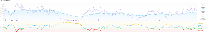

Post your CTL graph.
this year:
I’ve just started to ride more intense (I couldn’t find motivation in October-Nov).
I’ll do rest week now. (previous weeks were: 899, 700, 847, 749 TSS)
There’s a few red flags there. Loss of motivation for two months is a major indicator that you were burned out. Taking a week or two off is normal, needing that much time is not.
And you have several of those in one year it looks like (or maybe something else happened in that big break earlier in the year).
So it seems that you’re not a good judge of when you’re overdoing your training load.
You tell me that you’re doing 4 intense weeks then 1 recovery week. With how intense your weeks are plus your history of burnout, you really should either lower the load of your hard weeks or do a cycle of only 3 hard weeks before a recovery week.
