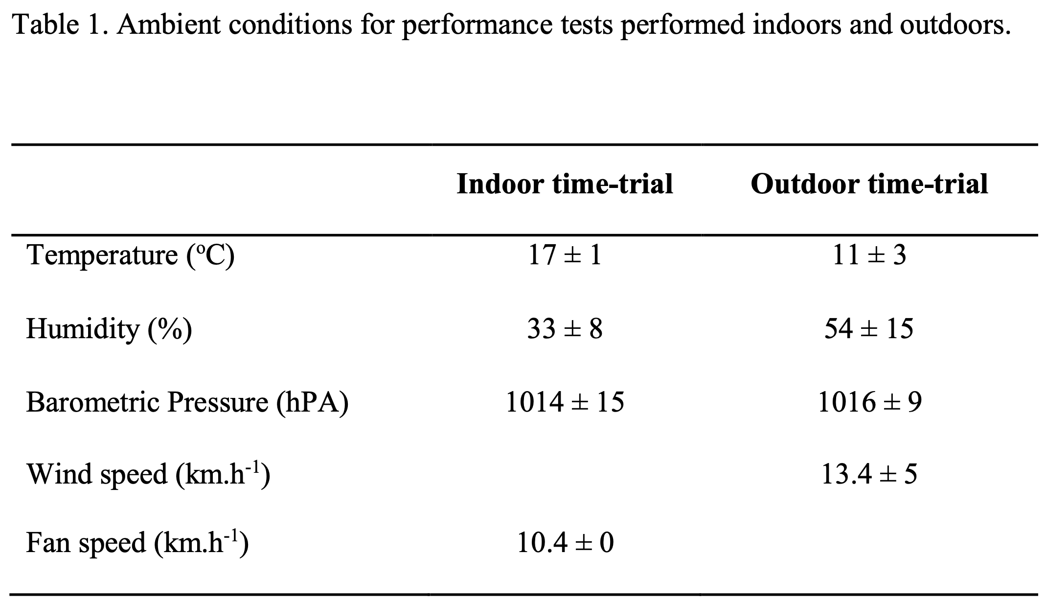

sorry this doesn’t directly help… here is a recent study of a 20-minute time trial and indoor/outdoor power output was about the same: An Analysis of Variability in Power Output During Indoor and Outdoor Cycling Time Trials in: International Journal of Sports Physiology and Performance Volume 14 Issue 9 (2019) and full version here: An analysis of variability in power output during indoor and outdoor cycling time trials - ePrints - Newcastle University
This feels like the type of study that you could find another study with different power between inside and outside. However this study had basically the same power inside and outside.
The conclusions were:
