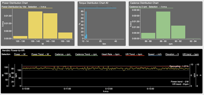

I’m getting eye strain from looking at Strava, @enki42 so here is a quick outside (Jan 2021) vs inside (Jan 2020) from my files…
Outside 4 minutes endurance pace, about 17W standard deviation around the average power (about 172W):
Inside 4 minutes at lower endurance power, about 7W standard deviation around the average power (140W - when ftp was lower vs above):
That was dual recorded, TR PowerMatch via BT controlled the trainer, BUT the power trace above was recorded on Garmin 530 via ANT+ connection to Stages gen3 dual-sided crank power meter. Less variations in power and cadence. Picked that inside ride because it was around the same cadence.
