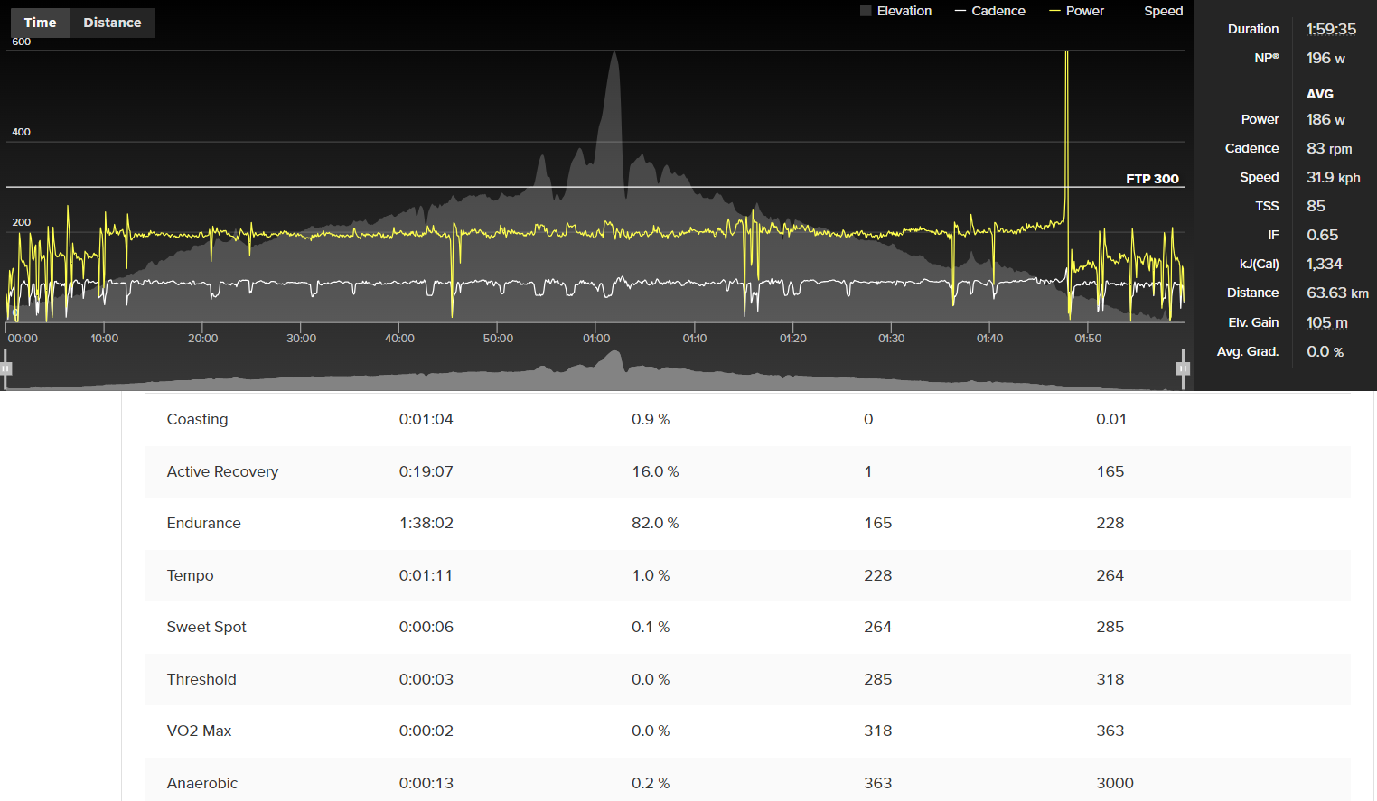

Here’s an example of what a steadier Zone 2 ride looks like:
This ride was also about 2 hours long, with 1h38m (82%) of the ride spent in Zone 2. The terrain wasn’t very hilly, but with some practice, you should be able to adjust your cadence when going uphill/downhill to keep your power in check.
