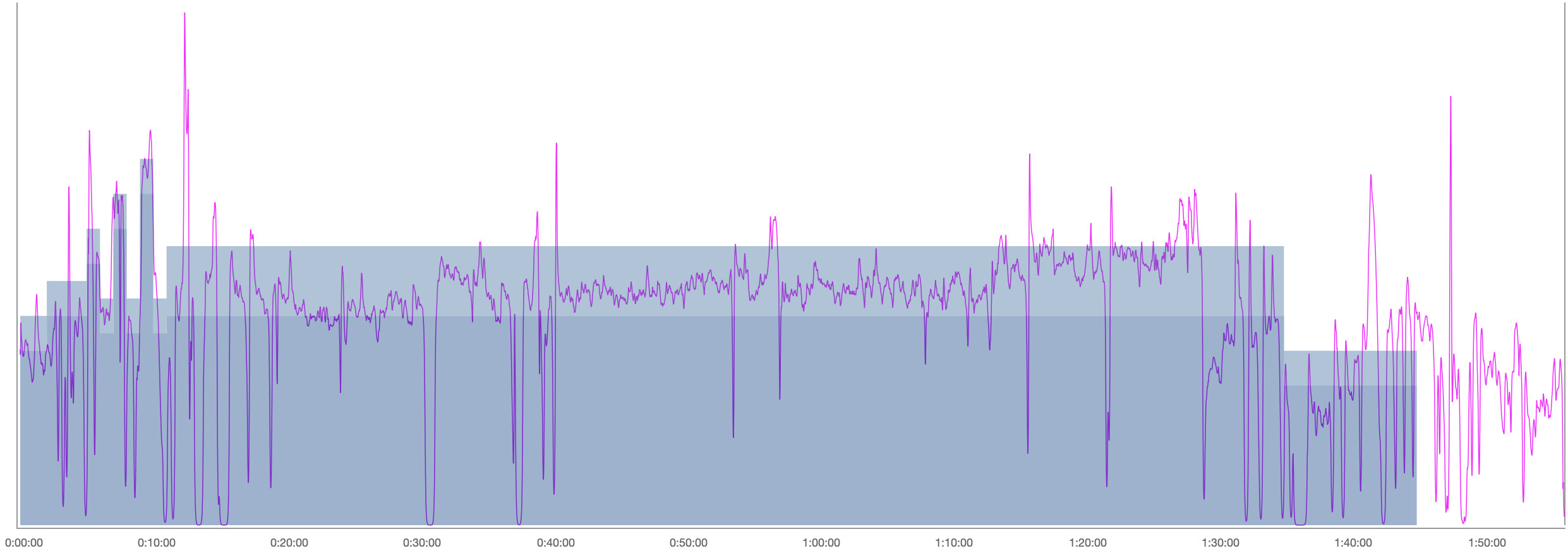

here here, last night with a 60-80% FTP target range:
Start easy, be patient and let the power come, and ride into it progressively. That was about 70 minutes of steady riding, usually shoot for 70-100 minutes of that sandwiched between warmup and cooldown.
