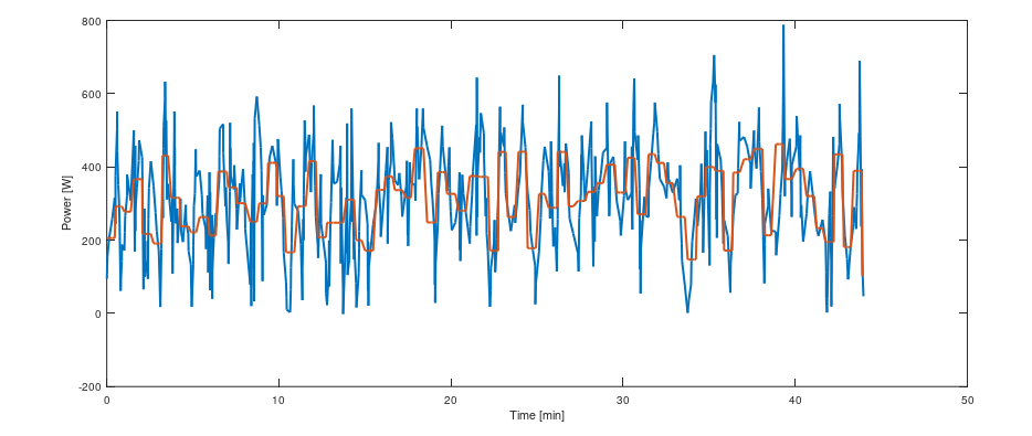

The full gas lap for the front group is around 40-44 minutes; I dug out from Strava the power file from a guy that systematically finishes on the front group and is slightly heavier than me.
In order to reproduce this power file indoors I did 30 second average of the power file and obtained the following data:
If I am able to finish this workout in ERG mode, it will mean I am completely prepared for next yearâs ride. I find a bit farfetched to think I can improve so much until next May (start of the season), but still the question is: how do I get there? (or close)
As you can see, the level is super high. There are truly fast guys around here, and an FTP of around 330 watts seems to be needed, but also surges of more than 460 watts for 30 seconds. The ride has an overall IF of 1.16 for 39 minutes at my current fitness level which is obviously out of I would say anyoneâs reach, and shows clearly why I drop.

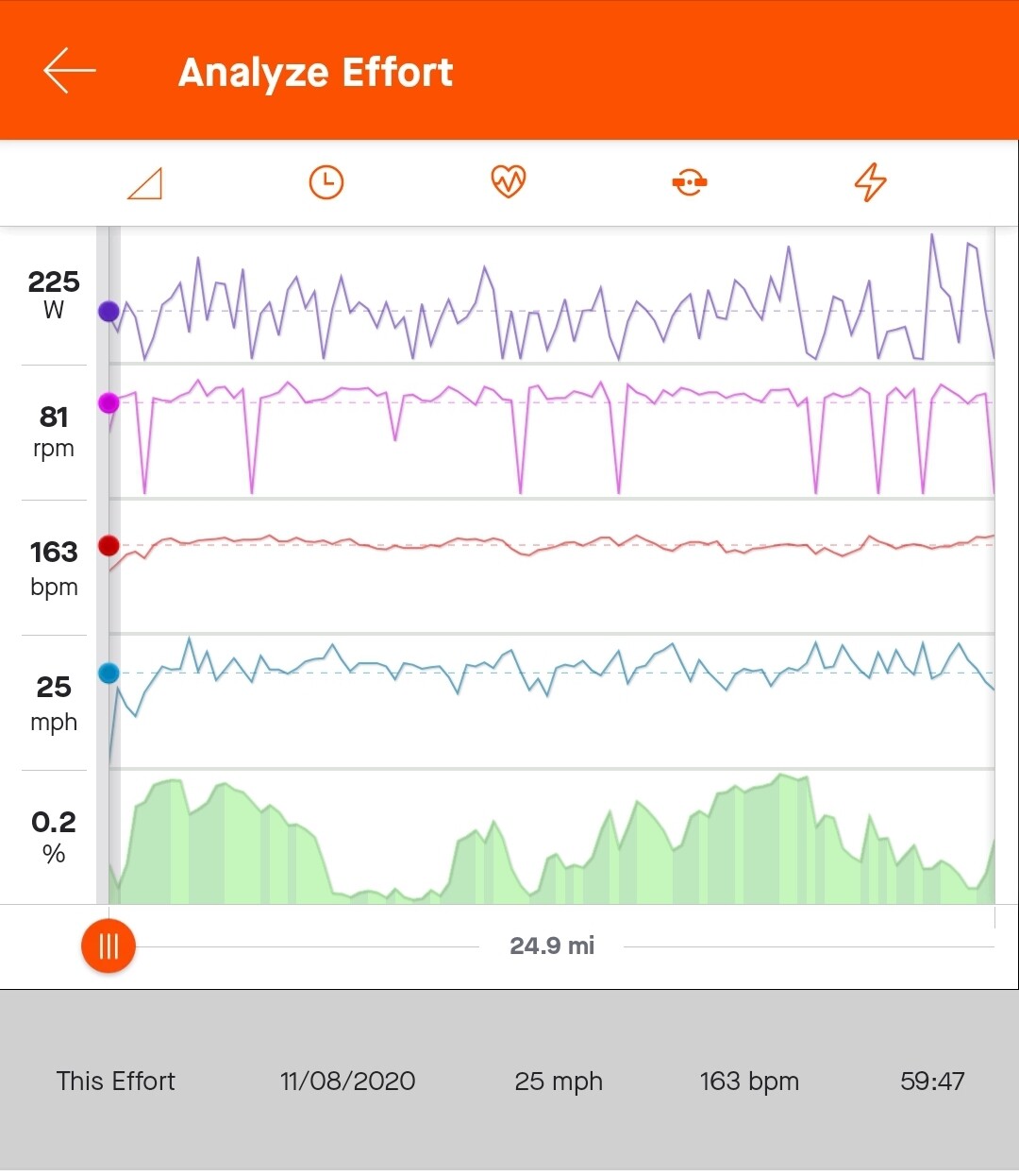

We do a Tuesday night Chaingang - same 25 mile flat loop (154ft elevation) every week. About 25mph for an hour.

Iâve done 335w NP/ 326w Av solo round our 1 hour loop, just to see how quick I could go solo. However in a group, it tends to be more like 300w for me due to time drafting. One week when there was a big group, I was going round slower people and putting in some big efforts, and still only did 309w NP/281w Av (277w going by Strava) because of the size of the group (8 or 9 riders). Here are some results from the segment on that ride:

I took the power curve from my buddy and I did 30 second averages:
I then created based on this power a Trainerroad workout, by adding a warmup and cool down:
It has 39 minutes at 334 watts normalised and is obviously currently outside of my reach.
