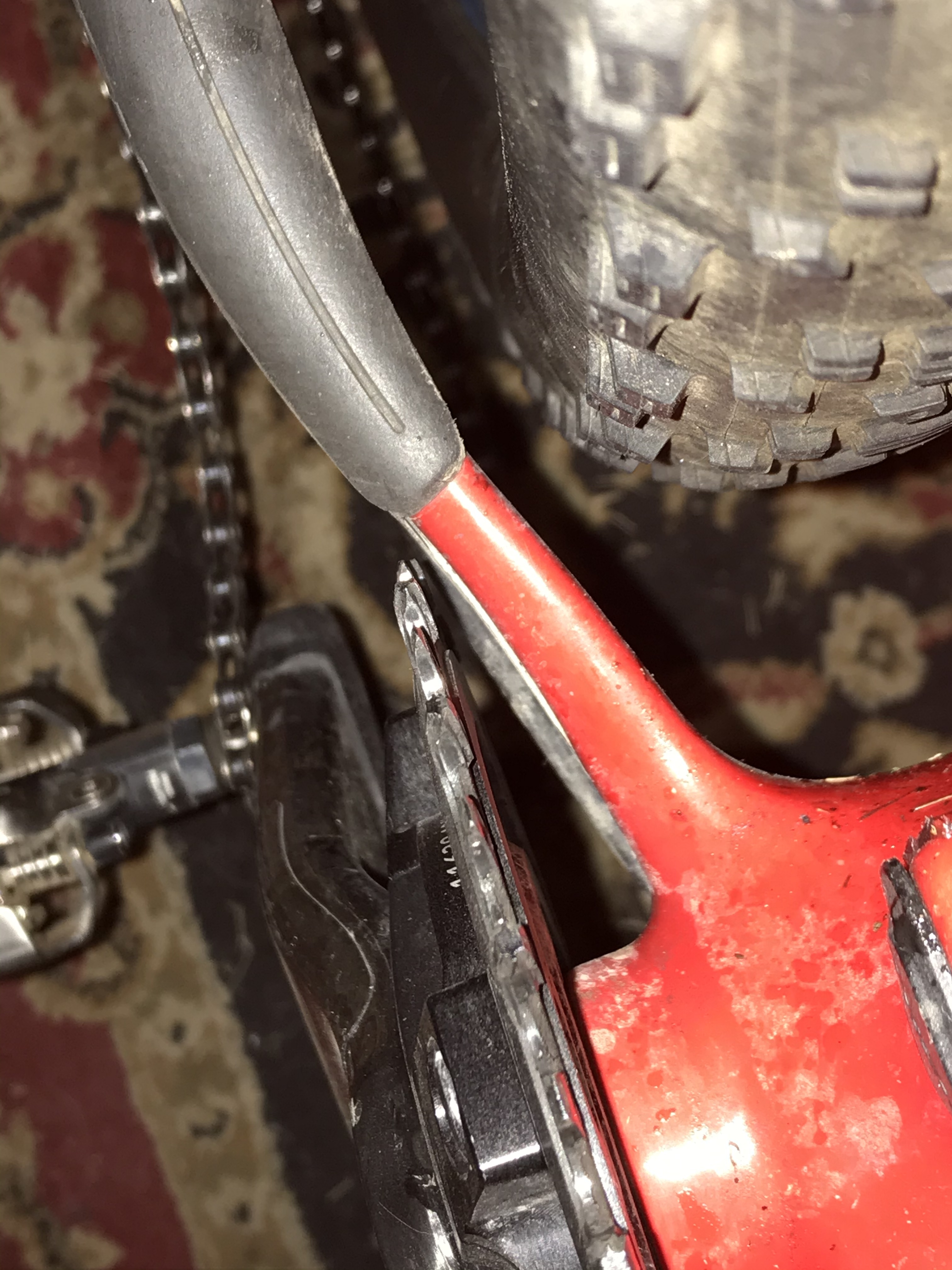

I run a 34t 1x11 drivetrain on my mtb. I need to run a 36t chainring but it would grind against the frame if I did that. Is there any way to push my chainring further away from my frame for me to be able to fit a bigger ring? I have a 2017 Trek Procal 9.7 if that helps at all.

34t non boost chainring pictured.
Can you take a picture of your current chain line. I’m far from an expert, but that does look very close to the frame/more in board than usual.

Nevermind, I ordered a boost chainring which should clear with the extra 3mm room.
