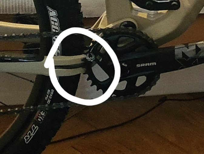

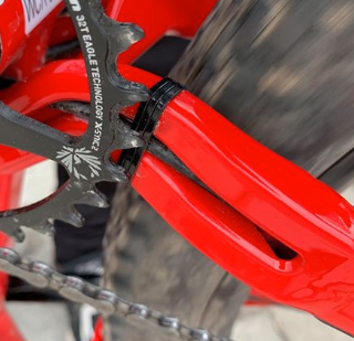

so fellas, my problem is the following
this is my bike, a ghost slamr 4.9, 29 wheels, size L
Manufacturer tells me I can fit a bigger chainring, current is 32T with 3mm offset, and that a 34T would fit
from the pictures, I am not sure if that would be possible, does it exist some kind of spacers, or usually what is the solution here, to ride faster, basically - I am attaching 2 pictures, so you can see it closely
current setup is sram 32t and a cassette 11-50 teeth. The store I have bought the bike told me is not a good idea to change the cassette, for example for some 10-52, as I would also have to change the hub and that for sure would be too expensive - what is your opinion and potential ideas for riding faster? thanks in advance!
