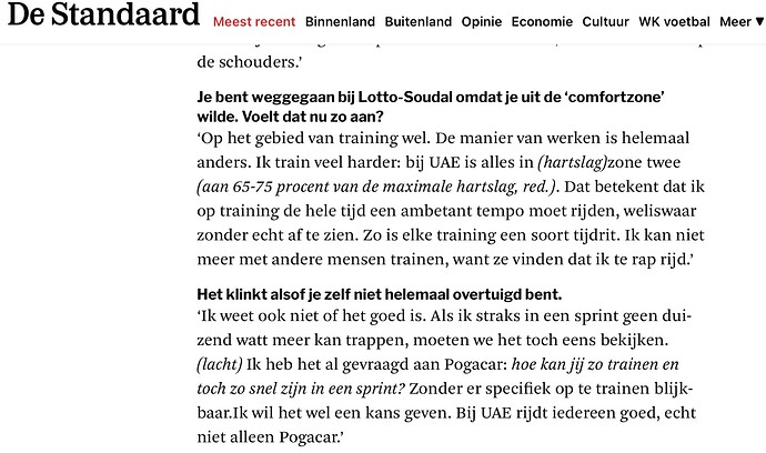

Interseting comment from Tim ‚El Tractor’ Wellens about adjusting to training at his new team UAE:
The way of training is very diffent at UAE. I train much harder: at UAE every ride is in zone two. That means I have to ride an irritatting tempo the whole time in training, but without really hurting myself. So every training is like a time trial. I can‘t ride with other people anymore, they say I ride too fast.
I’ve already asked Pogacar: ‚How can you traing like that and still be so fast in a sprint? ‚Without training sprints specifically, apparently.
Original source
