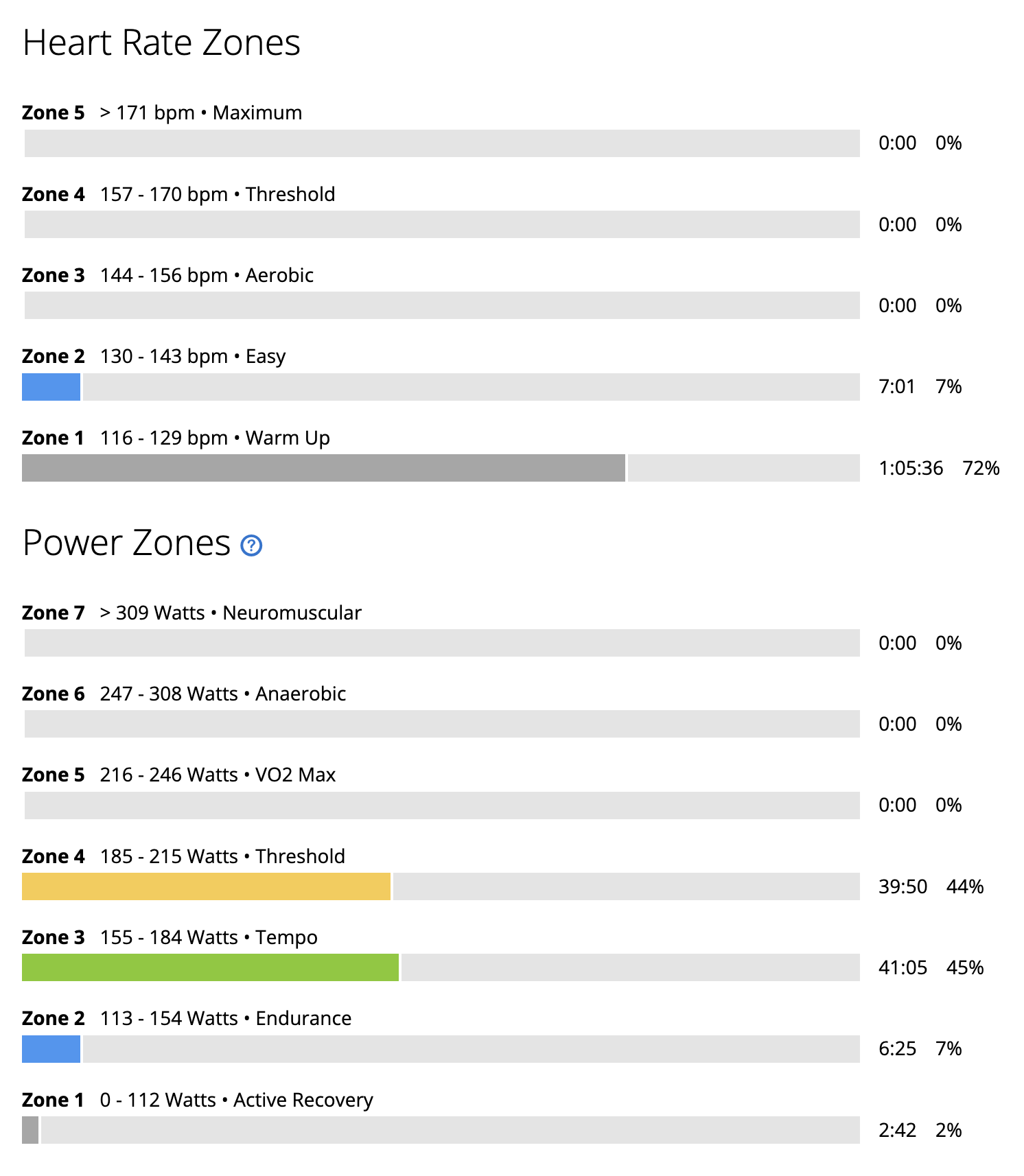

Hi all,
I recently took a FTP test (206) but my heart rate zones don’t seem remotely aligned. Here’s a 90 minute ride I did today:
As you can see, I was barely able to get my heart rate out of Z1 and that took riding at 200 watts for the last 10 minutes (I was not very tired). For Z2 training should I be using heart rate zones or power zones? Or perhaps RPE?
Overall, this seems like it might be a good problem to have. My cardiovascular system is well trained (I used to run a lot) and is likely in better shape than my legs. Is that good guess?
How did you set your FTP? And how were the HR zones determined?
I set my FTP using a TrainerRoad ramp test (206 FTP) and my HR zones are from my Garmin watch:
The watch can be an issue. I have heard that the way it reads HR could cause an issue during cycling or, as you said, being new to cycling your legs haven’t found you yet. As HR can be impacted by so many other variables I would suggest you stay with what’s constant. And that is power.

When you hit the 200w step in your ramp test, it looks like your HR was around 150. It was only 128 in the workout you posted in the OP though. Something is not adding up. Same equipment, same conditions, etc?
