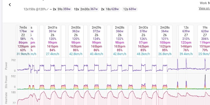

So I tried Dade +4 (2.5min no hard start). It was fine. So fine I did an extra 3 intervals. Partly because there is definitely too much rest between intervals, partly because no hard start I think. Like if I’m thinking about time in zone, I’m sure I didn’t get bang for my buck. I think I’ll try hard starts with 2.5 minutes on Tuesday next week.
Or maybe 120% isn’t quite right for your power target? Why not try to redo it, but shoot for the highest possible power you think you can sustain for 9 intervals?
Better still, make the intervals longer, to better stress aerobic vs. anaerobic metabolism.

I did 9 x 3’, with starts up around 130-150%, and ramping down to 107% for the last 90s. While not an easy workout, I was able to get through this without issue; I even turned up the last couple of intervals. It had an almost identical IF and TSS as the scheduled workout. This was my first attempt at a hard start version, and I really liked it, but I’m wondering how it compares in terms of training stimulus?
Any thoughts on this vs the stimulus from the scheduled workout

I want to keep the % at 120 because its actually around my MAP atm. So I’m going to extend till I can get it to 5 minutes.
