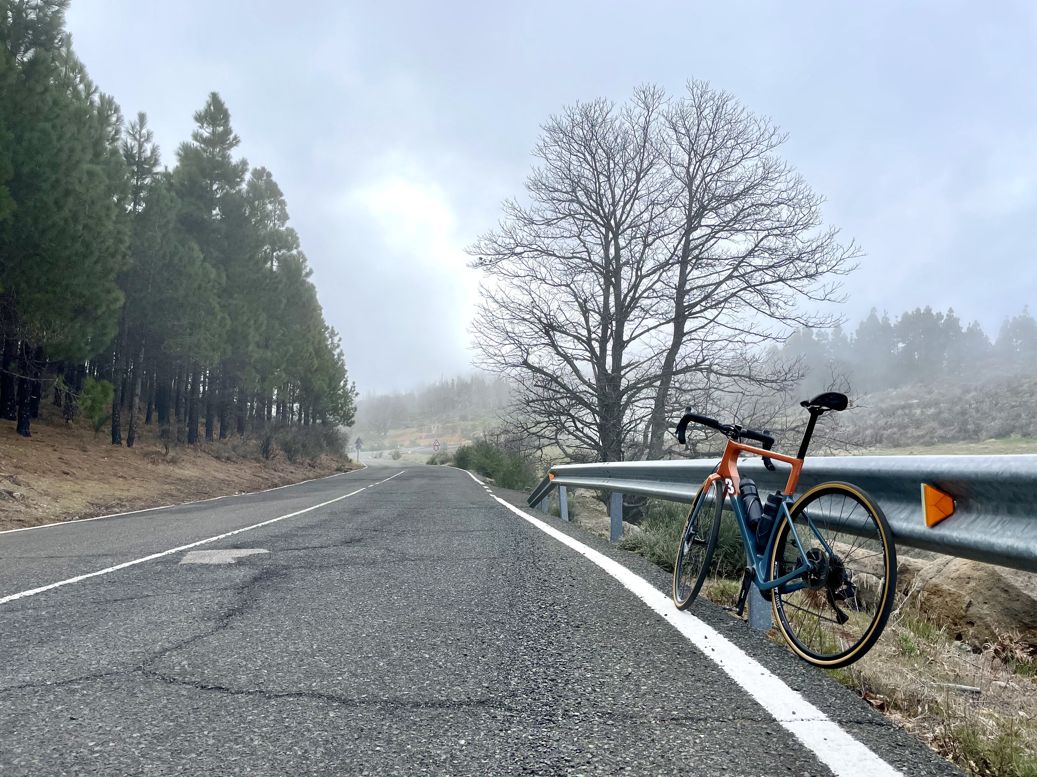

I have a 3T RaceMax that I use both on road (when training abroad) and gravel at home, here in Sweden.
I run DT Swiss for both gravel wheels (GR1600) and road (ARC1400 DiCut CL 62mm)
I have a Specialized Venge as well (2020) and I feel that the 3T feels very much like it on the road. Not the same snappiness but I feel very much at home on the 3T, coming from the Venge :slight_smile:
I run 50/34 front and 11-34 for both gravel and the mountains.

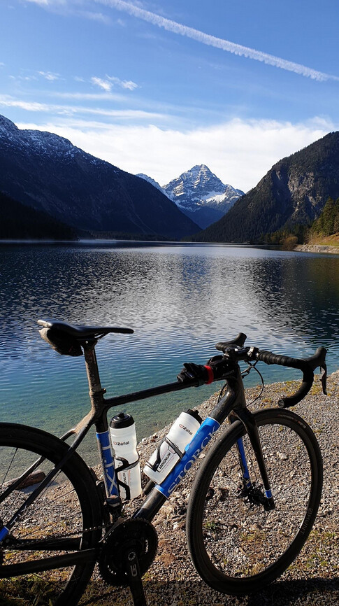

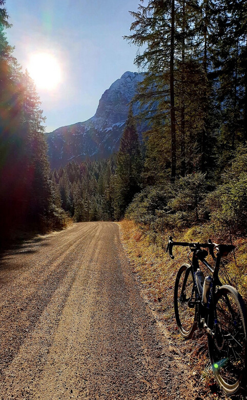

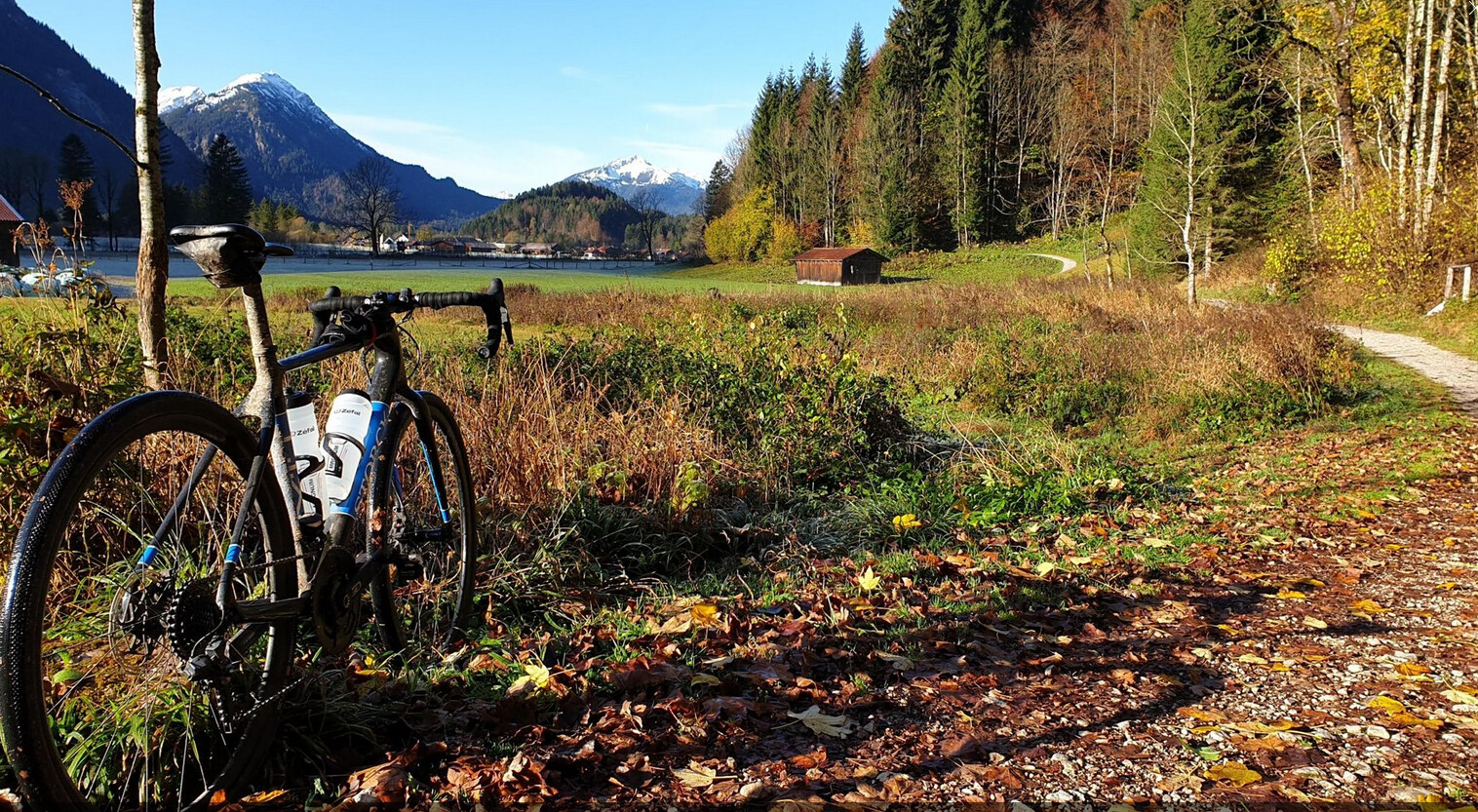

I retired my dedicated road and cyclocross bikes a few years ago. Best decision ever. Mixed surface riding is what I do most these days. Because of traffic and increasing behind-the-steering-wheel-a**hole’ism a dedicated road bike is not an option anymore. With a groadie you can avoid critical roads, use gravel roads/tracks and small roads only. A blessing.
I have three wheelsets, one for race day, one for road training (mostly used when on vacation with the family) and my day to day gravel wheelset.
