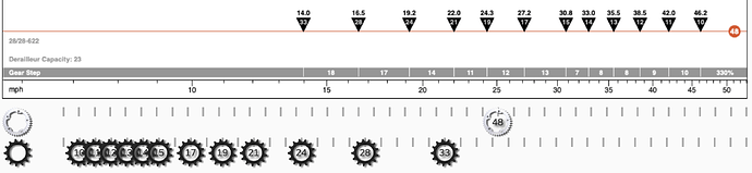

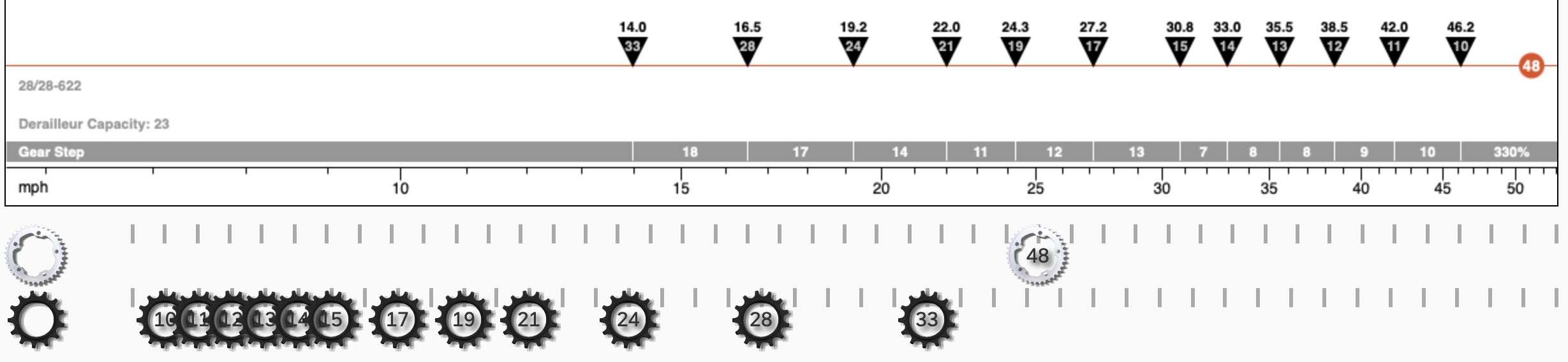

I often spin out 48/10 so I’m looking to see how much larger of a chainring would be needed to go a little faster on the top end, without making hill climbing excessively difficult. Currently my easiest gear is 48/33 (1.45) and I don’t want to make it too much more difficult as I already need to do ~400-500w on steep hills just to make it up already.
If I go to a 52T front and 10/36 rear theoretically I’d have an easy gear that’s about the same and one extra high speed gear, with spacing not being too bad. Or I could go with a 44T max gravel cassette and bump the chainring up to a 54 or 56, but there are less options for that size that include a powermeter in the chainring (currently running the SRAM 1x aero chainring but the options there are only 48T, 50T, or 52T). Perhaps there’s a track/sprint chainring I’ll find that works well with a bolt in PM.

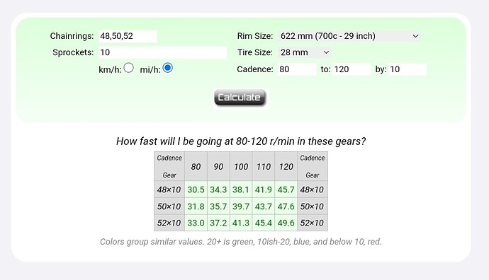

What’s your cadence when spinning out a 48x10? 110 RPM will get you to 41.9 mph/67.5 kph.
I’ll be totally spun out at around 130 rpm, which gets to about 50mph. This is down a hill. On flat ground I’ll sprint up to about 38-42mph or so before the cadence feels too high. I can sprint longer if I’m able to keep the cadence between 90-100 or so.
This calculator only goes up to 120rpm and estimates 46mph at 120rpm in 48x10 gearing with 28-622 tire:
this link should be setup for you to play around with:
