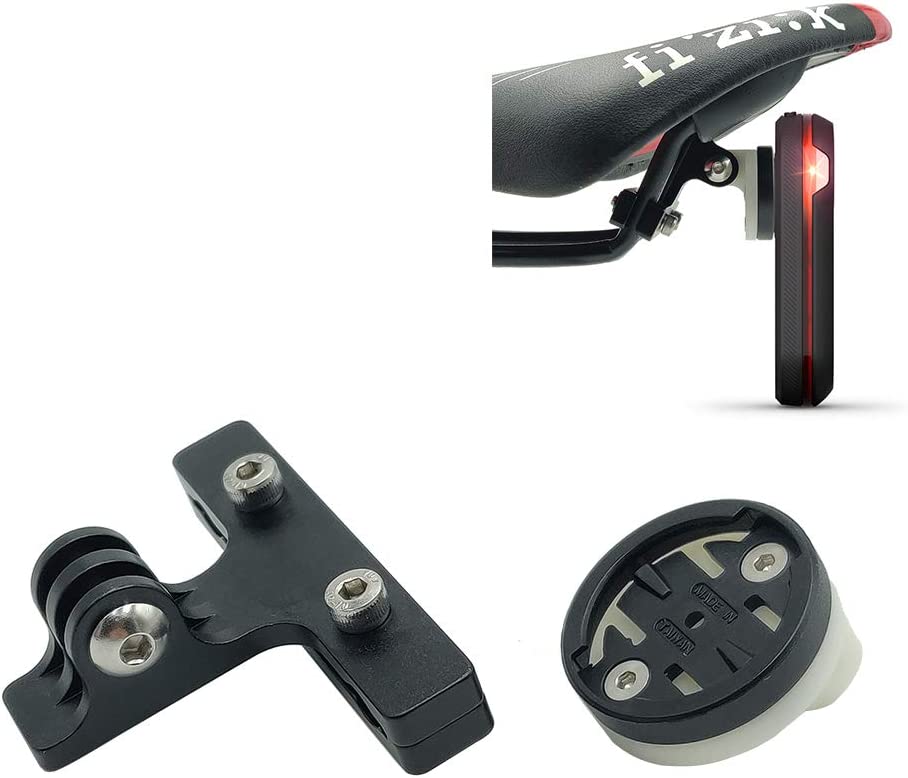

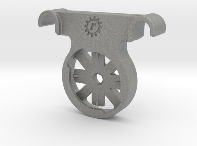

I haven’t had any issues with my fat bike, check out shapeways.com for alternate mounts. I have one that clips into my Fizik saddle that keeps it high in the air.
Or maybe something like this would work too
I use and really like this mount:
