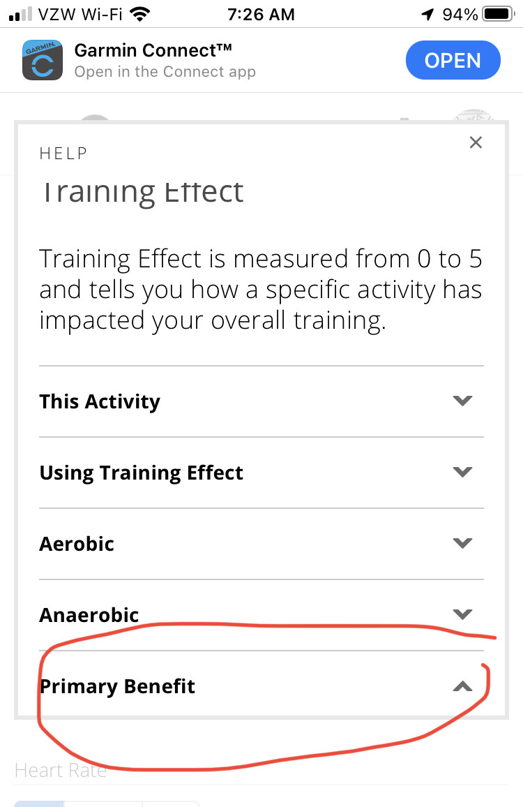

When looking at my data I use my laptop. Don’t have access to it right now so on my iPhone went to connect.garmin.com and pulled up a tempo workout. Here is how to find it:
Click on the question mark…
Scroll to the bottom, expand Primary Benefit, and scroll down some more.

However the 4 week load (anaerobic, high aerobic, low aerobic) has been in agreement with times that I wasn’t able to follow my coach’s plan because of life I was forced to cut out z2 / low aerobic rides. So I use it as a rear view mirror, and when low aerobic suffers I make a point of doing more z2 work.

Not on mine. Never had it. I only have a Garmin 530.
Do you have a Garmin wearable?
No load focus for me there. I get Training Status with tabs for Current, 4w, 12w, 6m.
That’s what I have. Believe you need a Garmin wearable to see it in iOS app.
