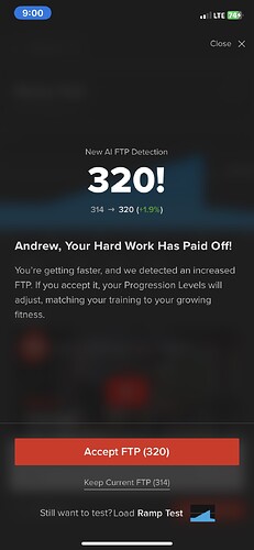

:thinking: used Ai ftp detection yesterday morning and after this mornings workout, garmin gave me an estimate too.

That happens to me also, it depends the workout and effort. I’ve had estimates 10-20 watts lower and the rare case of it being higher but then sometimes it’s spot on. I really don’t know but this mornings estimate was so close to what the algorithm gave me yesterday I thought I’d share it.
