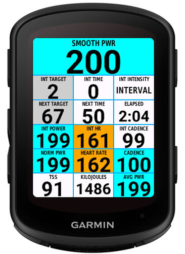

I added the workout fields to BigScreen, though I haven’t released it to the ConnectIQ store yet (need to do some more testing first).
Here’s a representative screen captured from the ConnectIQ simulator (though the target data is bogus). “INT TIME” counts down to 0, and then the “NEXT” data moves into the “INT” data. I think it’s useful to see the next interval so that you know what’s coming up. The Garmin APIs don’t expose the whole workout.
