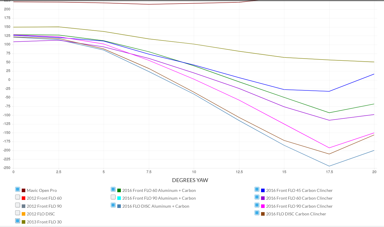

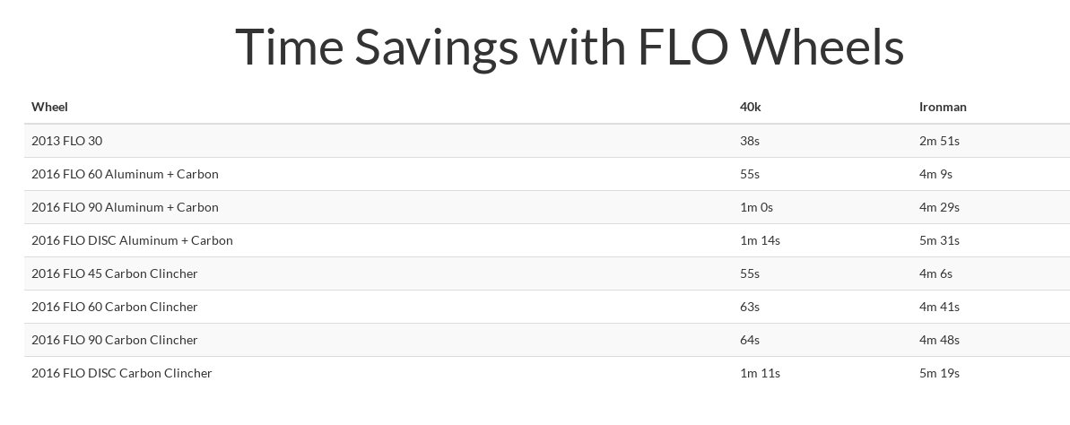

  • Flo states their fastest disc vs fastest wheel, saves you 10 seconds over 40km at 48kph over “common” wind angles https://www.dward.us/files/images/flo/TimeSaved.png
  • Flo’s numbers state the higher the YAW, the more you get out of a wheel, even a disc https://www.dward.us/files/images/flo/TimeSaved2.png backing up my thinking from earlier.
It does seem like a rear disc (cover or built disc) is faster than a deep wheel. But not all agree. I think a disc is faster, but making more of a difference the slower (and/or windier) it is.
To add more evidence to that, Flo found their Flo60 carbon was faster than their Flo90 at 0 and very low YAW but then the Flo90 becoming faster at higher YAW (about 7 degrees and higher). Looking at the specs, the most obvious reason is the Flo60 is a little wider, so matting better with the tyre at 0 and low YAW, but the depth of the Flo90 gives it an advantages once the YAW angle increases. Once again showing a deep wheel helps more the higher the YAW which you see when you ride slower and/or a windy day.
