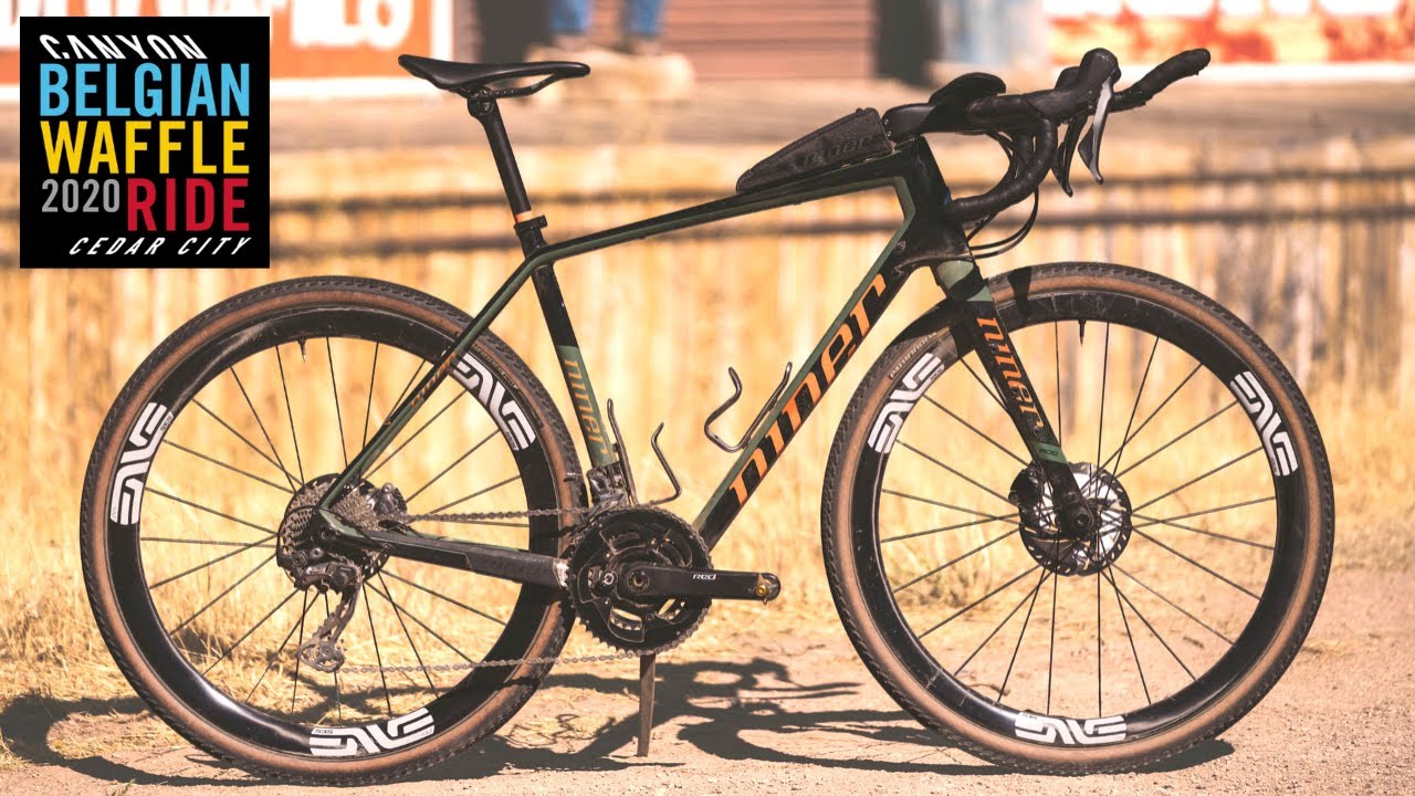

Check out Dylan’s Belgian Waffle recap
I believe he said he had inserts. I don’t think they were cush core, and it’s gravel, not CX, but probably applicable.

@Nate_Pearson I have a Gravel Time trial in two weeks to finish off the season. I put tubolights in because it has a rooty/rocky singletrack section on course. I hit that section at full speed and gained an entire minute on my buddies who were just working their way through it. Completely worth it for 23g. This is also what Dylan Johnson is running on his gravel set up for the BWR.
