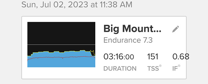

No. My KICKR appears to stay absolutely constant with very minor variation — but I use Zwift.
Nothing like ERG when you want to tune out at watch the :goat: :mountain_biking_man:t2: and :ice_hockey::mountain_biking_woman: dominate in Val Di Sole. Helps when it’s doesn’t stop raining and when it does momentarily it’s 94% humidity outside.
I’m going to guess you have left the default option of Power Smoothing in ERG mode on. Fine if you like it, but know that it shows a very unrealistically smooth power ling in the graph.
