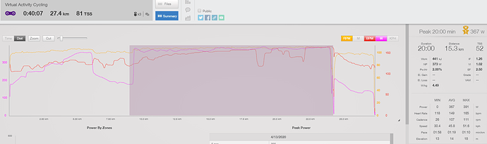

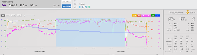

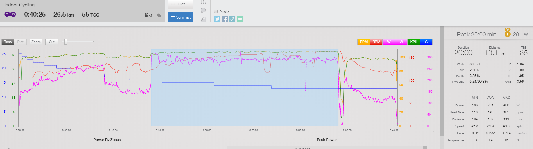

The fact my 2014 KICKR reads ~26% high doesn’t help. I did a 20min FTP validation test last week after my ramp test and had my garmin running to pick up the KICKR power just so i could see how bad the offset was.
This is the result;
4iiii: 20min avg = 291w, 291 NP
KICKR: 20min avg = 367, NP 373w
So yeah I can use my KICKR, but the readings are garbage.
I hear you on the KICKR mine is the same. I’ve turned off power smoothing through the Wahoo app; and also set the trainer to use an ANT+ power source - I’m using my Quarq to be used by the KICKR to manage power. You might want to check power smoothing is off, and also try having your 4iii’s be a power source for the KICKR? Also pretty certain that if you really focus on keeping your cadence within a very narrow band the effect will be minimised.
There will always be a bump at the start; just the time delay in the KICKR increasing power, the 4iii’s reporting the increase, the software responding to the increase etc; then the system realising your too high, and bringing down the power etc etc. This endless loop will create a bullwhip effect especially if the cadence changes.
