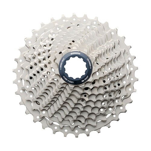

The cogs on ALL Shimano 11-speed road cassettes are spaced EXACTLY the same.
As I mentioned above, the 11-34 cassette is effectively more of a MTB style cassette. The main cassette width as the mounting flanges is effectively a 10-speed MTB cassette. This cassette requires the typical 1.80-1.85mm spacer when used on a road freehub body.
Indexing issues between a wheel and trainer are down to the subtle tolerance differences of where the exact final position of the cassette lands between each device. Manufacturing tolerances lead to a different left/right location, and when that is off enough, it leads to poor shifting and the need to adjust the derailleur using the barrel adjuster.
This is no different than having two wheels for the same bike where the cassettes are not perfectly matched. It is fairly common and something that can be handled quickly once you know the right adjustment process.
For those that want a “perfect” match between bikes and trainers, it’s possible to use very thin shims (like the ones for shimming disc brake rotors) to get the alignment between cassettes on different wheels and trainers much closer. It’s possible get them all close enough to eliminate the need for adjustment.

I’ve followed some of the advice here (barrel adjustments) and have used the 1.85mm ring that was delivered with the shimano cassette. Still, I can’t get the chain to run relatively smooth and there’s still friction if I shift +/- 2 gears.
Did anyone of you make it work to an acceptable level? In addition to the shimano spacer, did you also use the other rings that came with the trainer? I’m also thinking about giving it a try to use these very thin rings for micro adjustments…
Are you trying to setup a 10 or 11 speed cassette? It’s been some time since I set up my Direto but for Shimano 11 speed cassettes and hubs you install without any spacers. For 10 speed Shimano you use that 1.85mm spacer and the 1mm spacer that comes with the cassette.
If you put a spacer when you shouldn’t have that may explain why things are off.
Hi, using the Shimano 11s 11-34 cassette. What was explained in comments earlier is that it’s effectively like a mtb cassette so I’ve added the spacer that came with it. Otherwise the cassette is pretty lose. I’m just wondering if the other people here added additionally to the Shimano spacer also the spacers from the trainer itself. I’ll probably just give it a try since it’s really not running smoothly yet…
Which model cassette? Sounds like you have an HG800 which I believe is one of those new 11 speed cassettes that can fit on a 10s hub. Not 100% sure on the spacers to use but I imagine you’d need 2.85mm total of spacers (the 1.85mm +1mm unless you’ve also got a 2.85mm single spacer on hand). If that’s the case that should get rid of the slack in your setup as it sounds like you don’t have enough spacers in there if it’s loose. It shouldn’t be with no lateral play/movement at all.
I’ve got a Shimano 11s HG700 11-34 cassette on my bike and got the same problems with the suito.
I tried to align the suito-cassette but didn’t get it to fit perfectly. After reading about my HG700 cassette, I just decided to order another HG700 to mount it on my suito, but still got the same problems:
I can’t get on the smallest cog. My limiter seems to be set up correctly, as the derailleur sits underneath it. Anyway, it’s at it’s maximum as I cannot get it to move further out. But even 2 whole turns of the barrel adjuster aren’t enough to get on the smallest cog smoothly.
I used the 1.85 spacer delivered with the new HG700 cassette and even tried it without it. I will try to use 2.85mm total of spacers and see if it does the job better

I had the same problem - brand new 105 11sp cassette not working at all. It turns out the Direto instructions do not show the 1.85mm Shimano cassette spacer being installed on the hub prior to the cassette, which is standard on the 11 speed installations. Before installing the spacer, the cassette was not even tight on the hub, which is why the shifting doesn’t work. I installed the spacer and everything worked just fine - no need to even make a barrel adjustment. This is how it should be, ideally, right? I will contact Elite with this information, but by the time it gets into “print”, we’ll be at 15 speed cassettes.

  • This is not a 100% true, blanket statement. Most road cassettes up to 11-32 gearing do NOT need a spacer on the typical HG road 11-speed freehub body present on this and nearly every other trainer I’ve seen.
  • Do you have an 11-34 gear cassette? If so, that is actually using the MTB 11-speed freehub mount, that DOES require a spacer for use on the normal HG road 11-speed cassette.
  • This is also true for any of the 11-speed MTB cassettes since they are narrower and not the same width as the 11-speed road cassettes.
  • These are the reasons I expect that trainer makers a not making simple suggestions, since the details really matter here and are sometimes changing at a rate they can’t hope to follow.
  • It’s up to users and the makers of the cassettes to give guidance for when to use spacers or not with specific freehub body types.
I appreciate the quick feedback. I should have clarified it is an 11-34 105 cassette, My new Ultegra road cassette is also 11-34, and also has the spacer installed on the bike.
Thank you.
Yup, that all makes sense then. That cassette is a road cassette, but it’s unlike every other 11-s road cassette before it. The exception that is easy to miss, as you are far from the first and won’t be the last to hit that issue.
