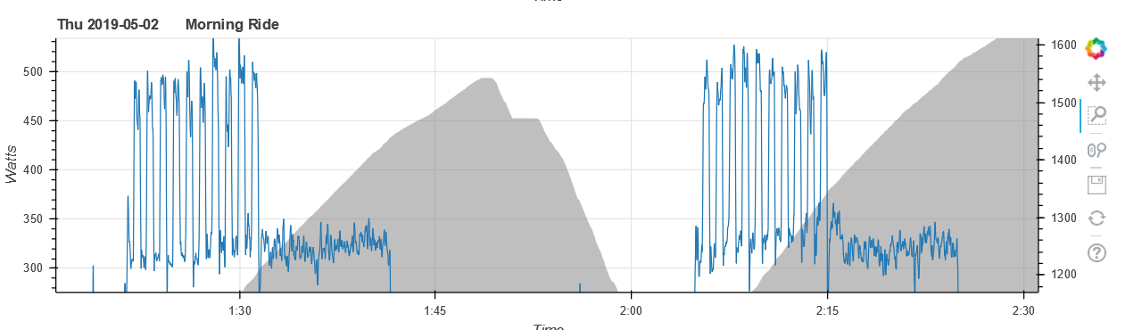

Snapshot of EB’s Giro 19 build. What I find striking, he trains basically the same way year round. May it be November, April or June. Even now.
and here is his interpretation of short-intermittent+threshold (I guess):

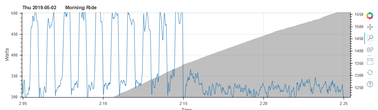

Looks like 10 times 40’‘/20’’ but what is the rest at? Guessing from his weight, it is at 130/90% of FTP which seems ridiculous. He than finishes with 10 more minutes at SS which will keep the heart rate elevated for a longer time. I was ready to throw up after 10 x 40’‘/20’’ and my rest was at Z1-2.

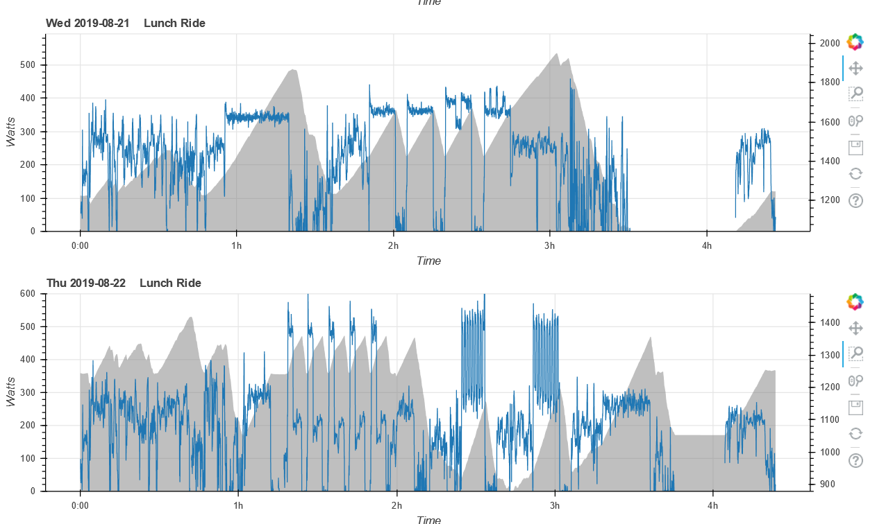

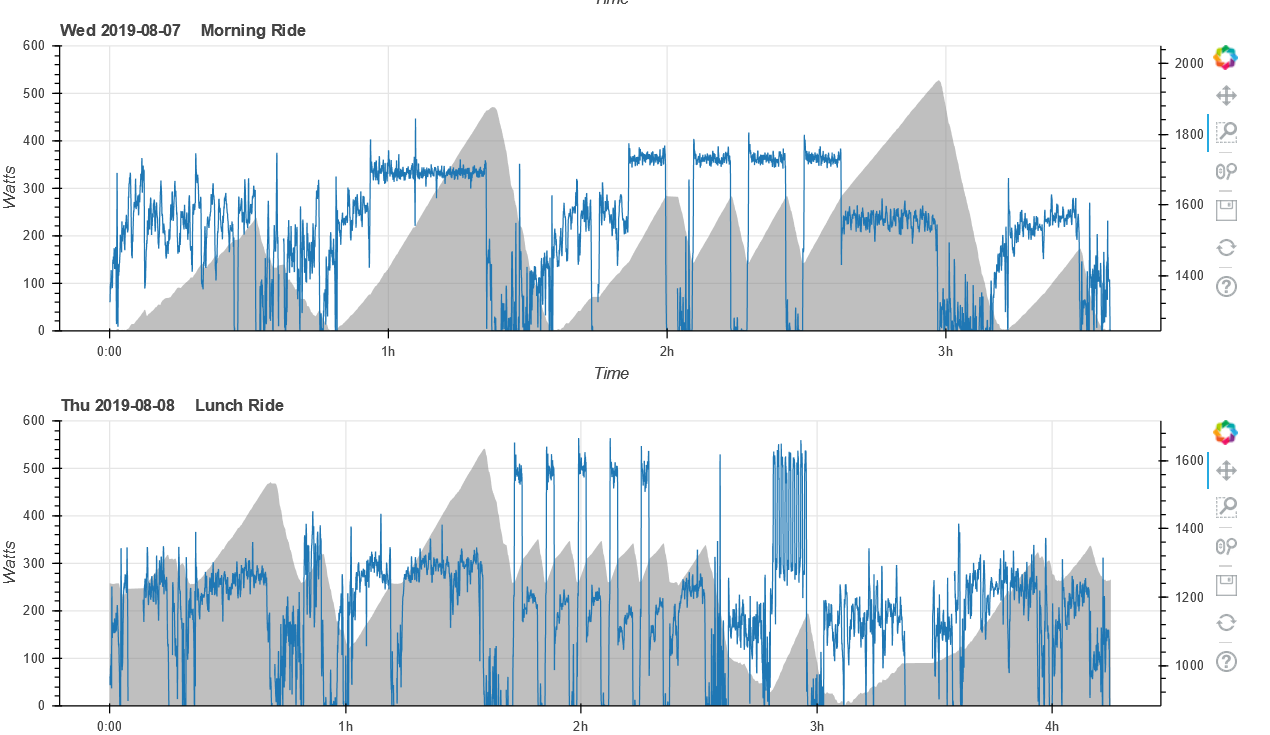

The over under work looked painful but these two caught my eye.
Are those attacks anaerobic and/or would they push into neuromuscular power and then drop to tempo or threshold? (Or is that hard to tell without an FTP)
The different cadences switch from ~50rpm to ~80rpm iirc I’m guessing to simulate the harder climbs, but is this also to stimulate a different response in adaptation?
I don’t think they are doing 50 RPM to prepare for harder climbs. They can always bring easier gears :wink: It might be the case in MTB world where you always run out of gears. Not on the road. It’s used to tire out your fast twitch fibers and make them work more aerobically. Also, it improves fatigue resistance of those fibers.

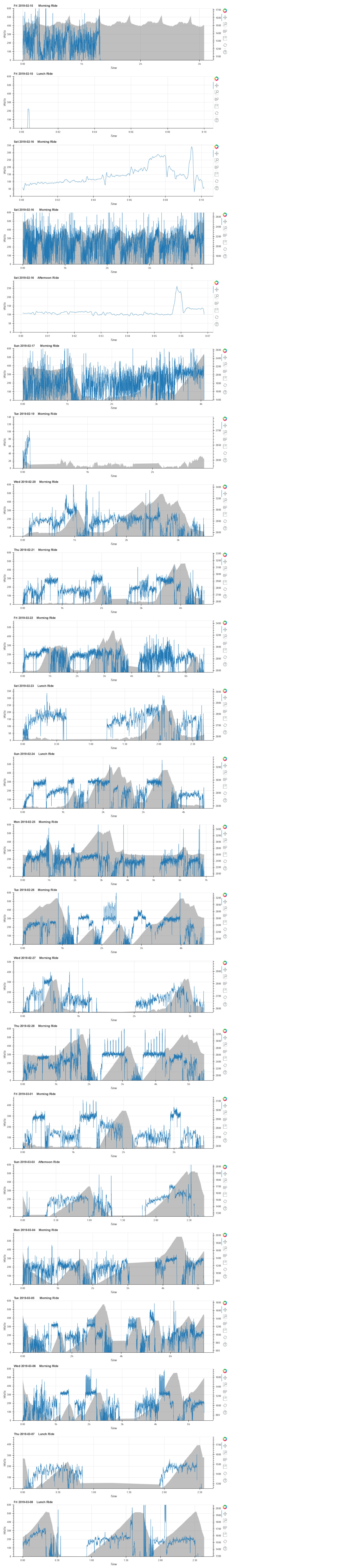

Some of your best data scapes to date. Love this stuff.
I’m thinking to transcribe these into TR format as Disaster #2, #3, #4, #5 and put up a winter challenge. Kidding… his back to back rides (2 days) look like same work load as my best weeks (7 days). Ooof
