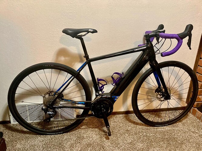

And it was very close. It’s specifically for Bosch which is what my wife’s Cannondale Synapse has. But I suspect you can get close to a decent guess on battery life once you adjust the parameters in their tool.
I’m still training my wife to slow down on climbs, to allow me to keep up and to conserve battery.
Our local HC rated climb to the top of the ski resort can take about 90-125 minutes depending and my wife uses about 75% of her fully charged battery. She’s not bashful about using the higher levels of assist. If we were to do more climbing we’d need an extra battery. For reference the total ride is about 35 miles, over 4,000 feet and can take over 3 hours counting stops and sight seeing at the top. The climb segment we ride is 13.9 miles and 3,900 feet of climbing.
