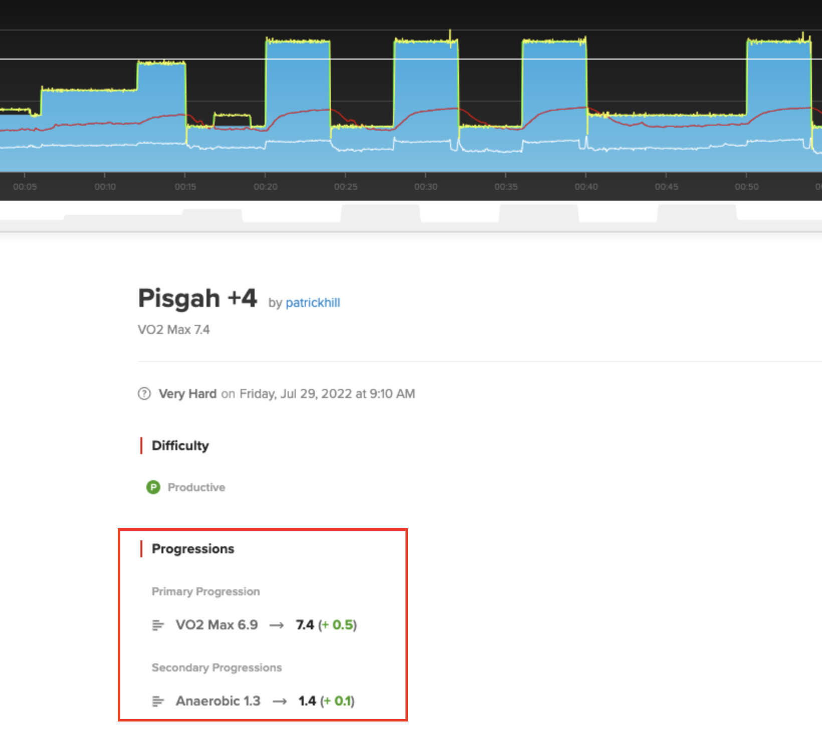

For example, when you completed Pisgah +4 on Friday (nice work on that one BTW!), it resulted in Progression Level increases for you in Anaerobic, VO2max.
It also had an effect on your Threshold zone where AT will consider that work when suggesting Threshold workouts in the future.
Workout levels address a single “target zone” in the workout’s design, such as VO2max in your example. However, as many workouts affect your abilities in multiple aspects of fitness, Adaptive Training makes sure to give you credit for that work when its merited and update multiple Progression Levels accordingly.
If you ever want to confirm if a workout increases more than one Progression Level, you can find that in the ‘Ride Details’ page for each workout:
The relationship between secondary PL changes across multiple zones exists for most workouts, where the severity of that impact varies based upon your pre-existing level and the zone in question. The ‘strength’ of that impact is individual for each zone, and is considered carefully by AT.
In your example of Venado (Sweetspot 7.0), your Threshold level would also be impacted, but it ultimately depends upon where your threshold level is at the time. The effect that Sweetspot has on Threshold is weak, but it’s there!

Secondary PL changes are definitely taken into account when determining Progression Level decay, and are also taken into account by Adaptive Training behind the scenes when it adjusts your upcoming workouts!
For the example in the OP’s scenario, we confirmed that their Threshold decay rate was affected from the workout that resulted in PL change in both VO2max and Anaerobic zones. This is what we’re referring to when we advise that the workout “also had an effect on your Threshold zone where AT will consider that work when suggesting Threshold workouts in the future.” :sunglasses:
