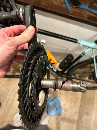

In other news after a few creaks recently my crank completely failed on the next ride I did. I don’t think it had any impact on my power transfer at the weekend but I’ve never seen the spindle fail like that. I tried to accelerate through some traffic lights and felt the tension evaporate.
I’m replacing with a shorter crank due to availability online - 165mm instead of 172.5mm. Interested to see how the shorter crank length compares. Slightly more clearance for pedaling round corners can’t hurt.

I feel like to succeed at crit racing, you basically need to be OK with crashing. Also, shorter cranks FTW. I use 155 cranks on my bike and rip corners pretty hard. Hearing the pedal strikes behind me were a mix of satisfaction and cringe.

Are you working against yourself on the pedals? It’s not easy to break a crank that way. You’re using pedal PM? Maybe 360np was making it to the chain.
