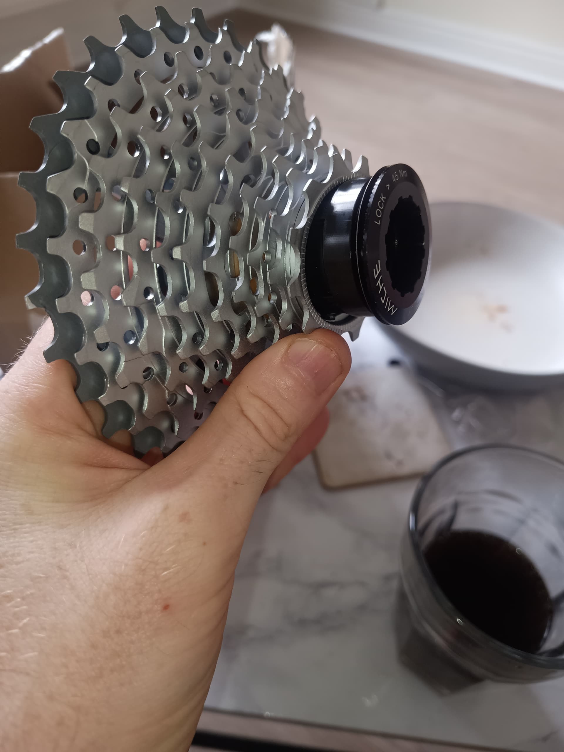

This picture is a miche primato light 12-34 cassette with the final sprocket replaced by a 32
This gives
32,30,27,24,21,19,17,15,14,13,12
For me ideal and a not something achievable in a conventional manner
Final update on this
I’ve ridden the bike for the first time today with this cassette, I had some concerns regarding alignment of the ramps between the 30 and the “extra” 32t, however the shifting is flawless, easily equal to the ultegra cassette it replaced, there is no issue under load on any of the top 4 sprockets which I deliberately tested under high effort on short climbs at ~20% to check for any issues.
An unexpected benefit in the big ring is a slightly quieter chain on rolling terrain which I attribute to being 1 sprocket further outboard when in eg the 50/27 combination
I am using a dura-ace chain and 1st gen etap derailleur, I’ve seen some reports suggesting that a newer Shimano derailleur with the shadow style is less tolerant of “unusual” cassettes as the top jockey wheel sits further back relative to the wheel axle so perhaps this is something to consider for a Shimano user.
