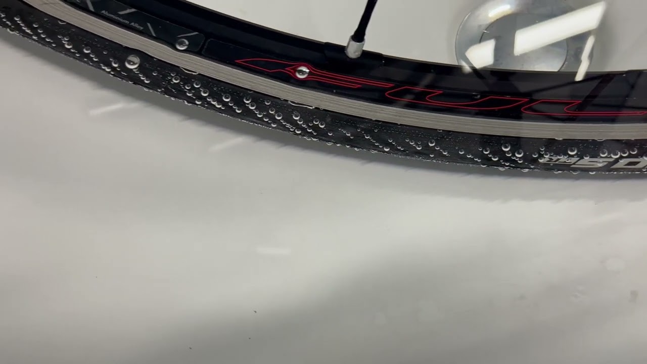

I am sorry about misunderstanding. It’s not sealant, it’s air that bubbles out when I put the tire in the water. I will make a video tomorrow. Today I was riding again and lost half the air in about three hours - from 70 psi to 35 psi.

Ah, gotcha. I’d add a bit more sealant (maybe mix in some glitter) and see if that helps. If not, take’em back to the shop.

Here is the video of the sidewall leaking air. This is not sealant, it’s just air bubbles. The tire is pumped to max pressure - 73 psi.
Yeah sealant will take care of that eventually, but as others have said it might take a few rides and you might have to top it up a few times as the first doses of sealant may get fully absorbed into the pores.

Another anecdotal experience here…when I mounted up my gravel tires a couple weeks ago, as soon as I pumped them up and seated the bead, big, steady hiss of air. Did the tubeless dance, hiss went away in less than 3 seconds, and they’ve been fine since.
I certainly do this every time with both sides. With this tire it does not help.
I’ve had tires with porous sidewalls that never stopped weeping. I wonder if scrubbing the inside of the tire with soap and water first would help. Sometimes there is a slick film of something on the inside of tires. I wonder if it prevents adhesion?
I also read one time where team EF was pre-treating the inside of their tires with a coating of sealant (painting it on). Something like that might allow the sealant to dry nicely on the inside of the tire.

Tip from the old days when there was no tubeless Race King. With sealant in the tire ride with minimal air pressure several times around the block. Minimal air pressure! Sidewalls will stretch and open up for the sealant. A little more sealant can help.

Yes, that could be the case. I think I should have wiped the inside with isopropyl alcohol. I will try this next time I install the tire.

Yesterday it went from 73 psi to almost flat, today it went to 18 psi overnight. So maybe it will improve, but it takes waaaay too long. I think washing the inside with isopropyl alcohol before installation could be a good idea.
