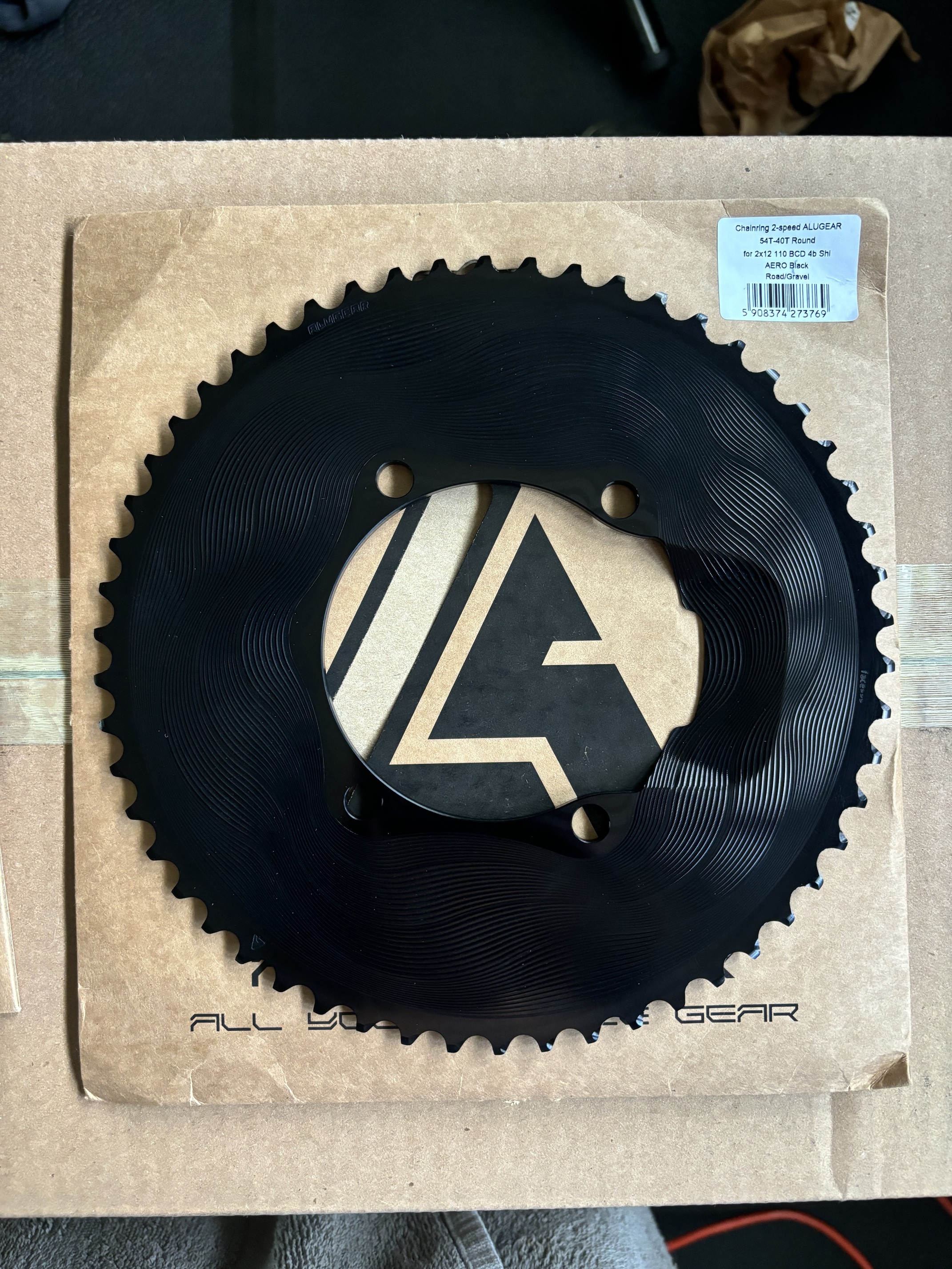

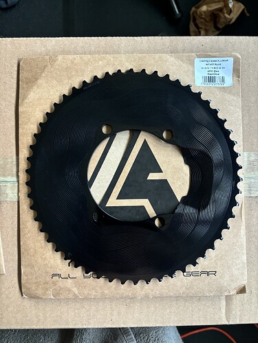

Just want to update this. My alugear 54-40 chainrings were shipped on 3/18 (after the revision) and I have been dropping my chain on the outside of the outer chainring in the 54-11. Checked everything (front/rear derailleurs, chain length, chainline) with no success. So I believe the flex in the chainring hasn’t been resolved. I emailed Alugear and I’ll update when I hear back.

Have you got a derailleur there or retainer on your 1x set-up? I believe it’s the chainring flexing and pushing the chain into the derailleur which forces it off on my 2x set-up. No derailleur no issue is my thinking. I ain’t testing it again though :joy:
Yes under load, but not even during a sprint. It always happens when trying to push a 54-11 down a descent. Not sure what’s going on but I’m not even putting that much power down when it happens

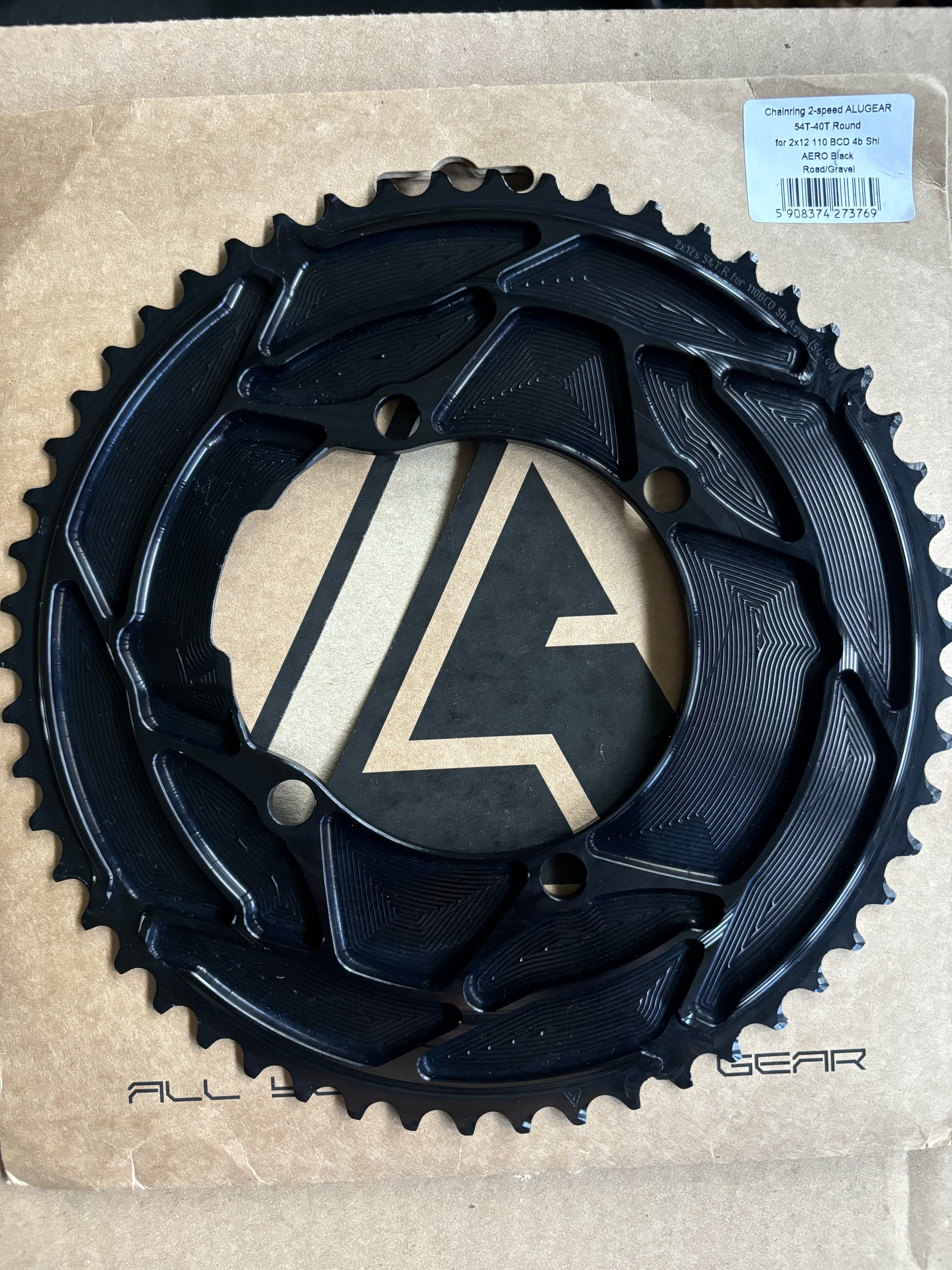

So far on the trainer it’s been okay in the 54-11. I just got it installed a few days ago. There is more material on the back side of the 54t chainring and the shift quality seems to be improved to compared to the last model. Alugear really provided great customer on their end. They sent me a new 54-40 and replaced the scratched up aero cover.

I’ve got my new rings as well and they do feel substantially stiffer in hand.

Sadly I’m just finding this thread now. I’m on Ultegra di2 12 speed. I got my Alugear 54-40 in April 2024. Chain slipped in a 35 mph crit sprint at the end of May. Didn’t crash, but whacked my knee pretty good on the top tube. The chain slipped right at the beginning of the power stroke before you really get up to high rpm. Lucky not to go down. I put it off to improper front derailleur adjustment. I didn’t end up racing in anything that came to a sprint after that last year, but it happened last weekend in the first race of the 2025. Same exact situation. Took it to my local Shimano expert and he made some fine adjustments. I tested it out yesterday in training with the same results. I was able to make it happen while in the saddle, so much safer. I’ll be switching to Dura Ace and looking for a refund from Alugear.
Have you got the updated chainrings? If it is still happening with the new design they need to do a full recall.
I’m not sure if mine are updated since I don’t have anything to compare them to. The ones I have look like the image further up in this thread that are apparently the redesign. Some additional searching found a few other threads on different forums describing the same issue–sadly with some hospital trips. I don’t know how recalls work for companies outside of the US. Sounds like it would certainly be the right thing to do. I emailed them to request a refund.
