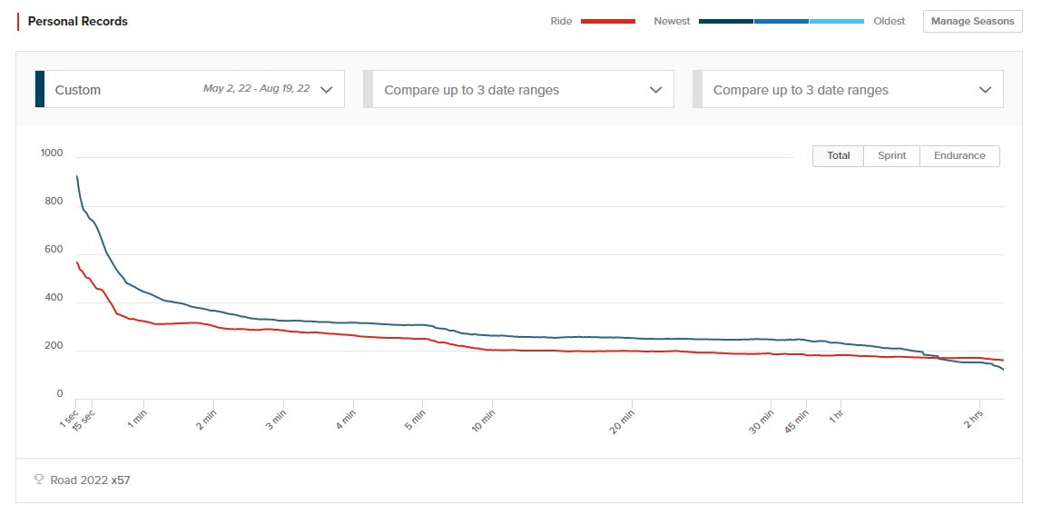

However, for the first half of the race I don’t believe I was overreaching by looking at my power numbers. My weekly rides I usually ride for 1:30 hours and end up with 0.90ish IF. The first two hours of the race I was at 0.77 IF and finish in 3:40 hours with 0.81 IF.
Here is a snapshot of the first 1:45 hours which is right were I started feeling that cramps were coming :cold_sweat: .
Comparing to the last 12 weeks:
Snapshot of last three weeks of weekly morning rides:
And here is the entire race snapshot if helpful for the data curious:
I’m a small guy (5’6", 132 lbs.) so the ranges are probably lower than what people are used too :sweat_smile:
I know the total mileage was going to be hard for me due to my endurance this season and was expecting to feel fatigue or even cramp later in the ride, but not as as soon as 45-50 miles in.

Figuring out “what was different here?” is a good exercise. Bike position may be one difference, and I have also found that riding with a hydration pack or on gravel can beat me up in a different way than I typically ride.
It seems a bit odd that your power on this ride would be quite a bit lower than on your typical group rides. Perhaps you’re a zen master and just did your thing as everyone else hammered the start (generally the case), but consider whether the power data is consistent with your effort of how hard you went on the race. Perhaps the power meter on your race bike doesn’t lend itself to comparison with the power data from your daily bike?
