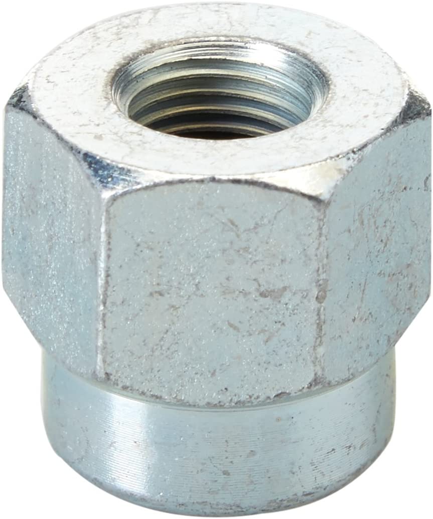

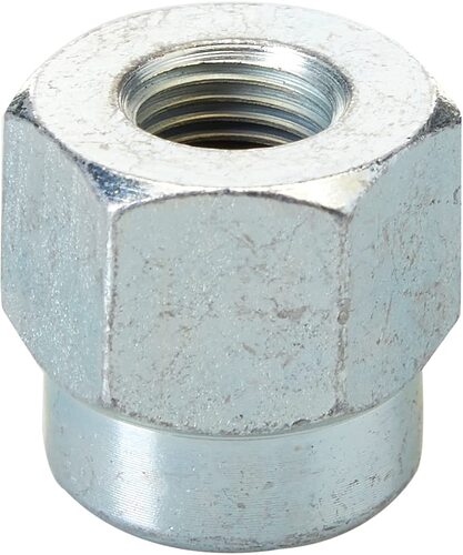

Tacx sell axle adaptor nuts. Have to check if your son’s axle is the right thread diameter and pitch of course.
These do not fit all trainers though due to their shape, it would not fit on a Decathlon trainer I had. but obviously suited to at least (some) Tacx trainers.

The TacX adapter looks promising - I am thinking we’ll get him his own trainer (mostly so I don’t have to disconnect my bike from the trainer all the time).

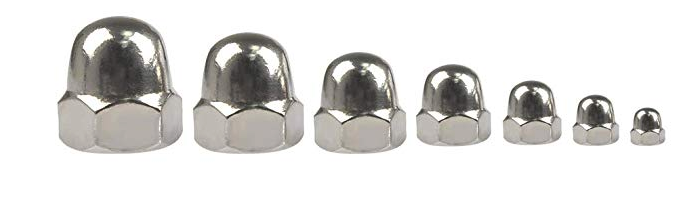

If you have access to an Ace Hardware, or similar store, go there and find their metric nut section. I suspect an Acorn Nut might work for your needs.
Take one of the existing axle nuts with you to confirm the proper size and thread pitch.
YES! This looks promising! :+1::+1:
