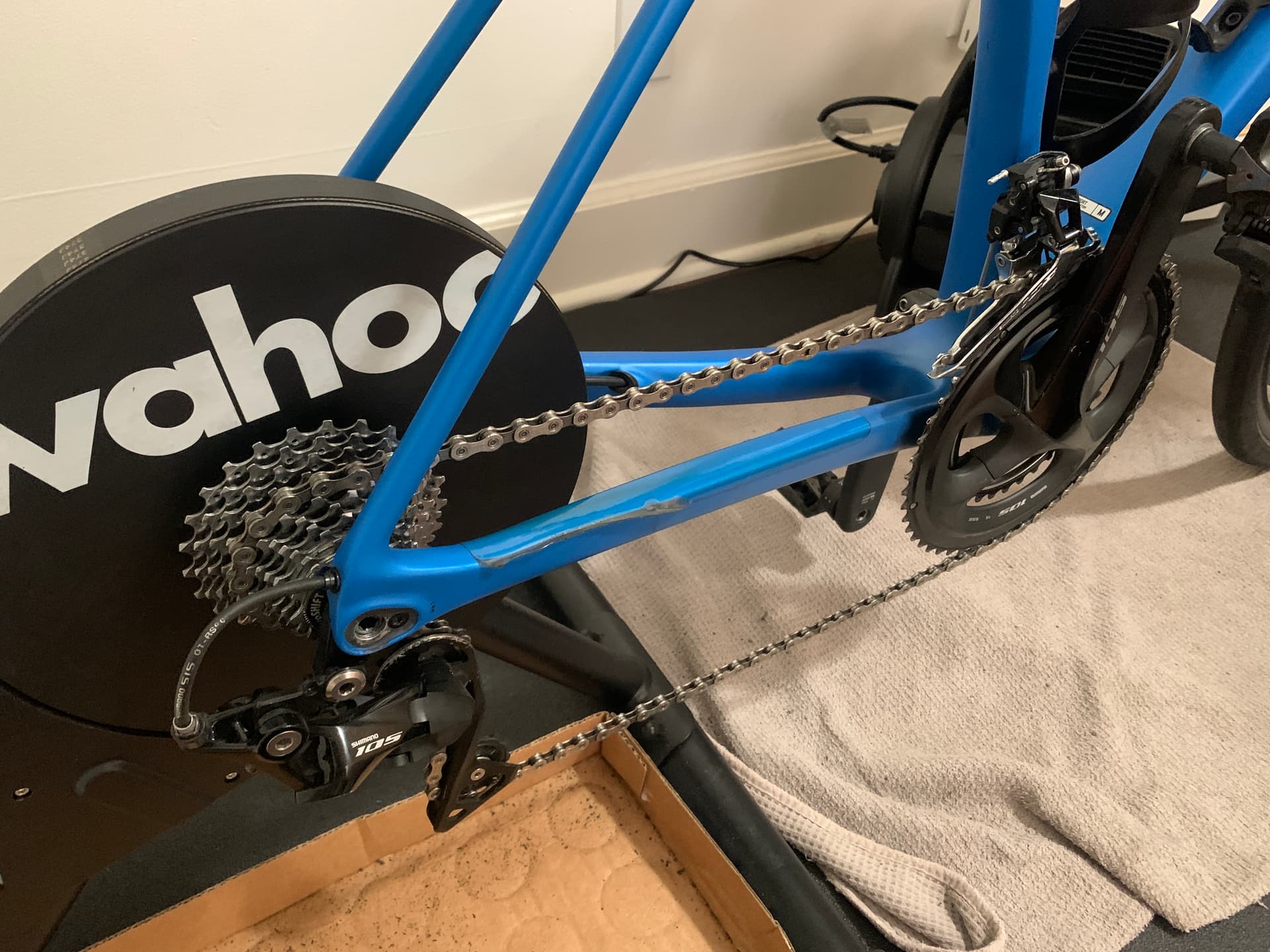

I see. Can you send a pic of your drivetrain in the gear you were using? And a pic of how the Kickr is positioned?

Your drivetrain looks very clean :+1:
Puts mine to shame.
