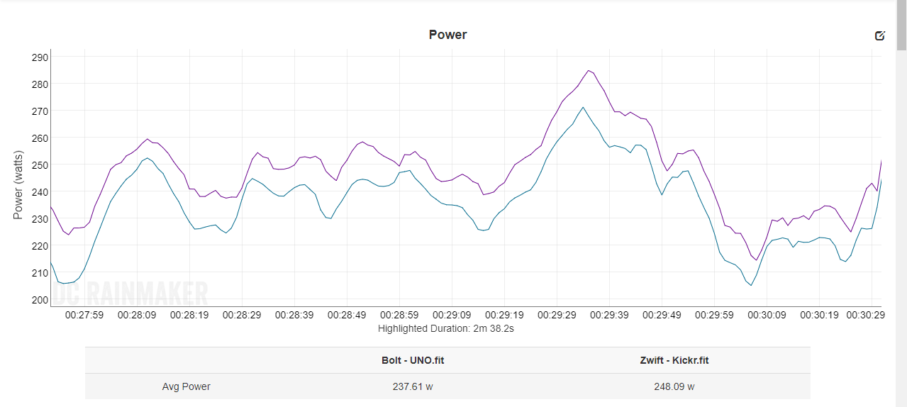

@mcneese.chad - I took your advice and did a 10 min warm up of the trainer on Zwift with a few efforts for the pedals - I then did a calibration using the TR app on both the Kickr Core and the UNO. I’ve then done a quick 30 min on Zwift (no ERG mode) and while things seemed to have tracked OK there looks to be a consistent difference with the UNO’s being c10-15w lower than the Kickr - I’m guessing some of this can be accounted for with it being single sided and if I’m right leg bias that could account for the difference?
Here are some quick comparisons - lower lines is the UNO ;
Do you think this amount of deviation is ‘normal’ or maybe, better put, acceptable?
Cheers.
Could be 2 things
  1. a left/right difference
  2. electronic brake adjustment needed on the core.
A friend of mine has the assioma duo and they are basically BANG on, just SLIGHTLY delayed on the assiomas.
If you perform an “advanced spindown” in the wahoo app for your kickr core, it will test and adjust the electronic brake as well, which MAY clear some of the discrepancy ( it dropped a friend’s “ftp” like 30 watts to be much more realistic lol )

I have a feeling I’ve a left / right imbalance - just not sure I want to spend another £400 for the DUO upgrade kit when I’ve just purchased the UNO to prove it!
Think I’ll just do another ramp test on TR using the UNO and then use PowerMatch for all my future workouts indoors.
