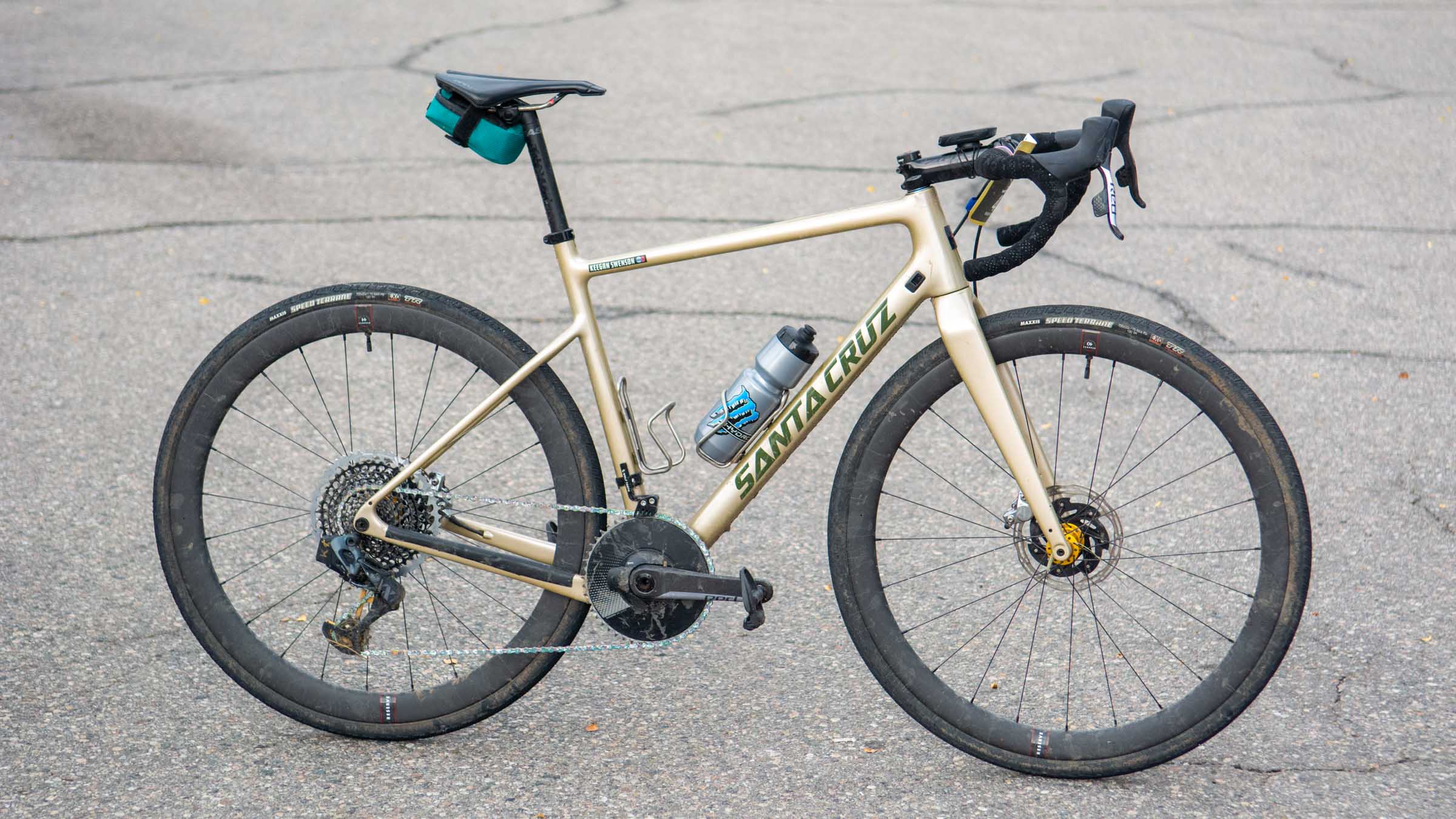

Yeah, I’m leaning towards Force XPLR with a 9-46 e*thirteen cassette. Seems to be the most flexible possible option.
This is what I’m running. It’s been great, no complaints at all.

If your bike came with XPLR the value play is to swap to an Eagle chain and eThirteen cassette, but if building from scratch I’d say there’s no big reason not to go full SRAM mullet. I guess the XPLR derailleur is cheaper, but having the Eagle AXS derailleur opens up 10-50 and 10-52 cassette options. That could be nice in many scenarios. As to whether you should get the trigger with it, well, I guess you could sell it or keep it in case you ever build a flat bar bike.
Would it be really silly to add the Red Aero x1 crankset in a mullet setup? So 48T front chainring, 10-50T eagle in the back. No other reason besides this is the only one crankset I can get my hands on at the moment, plus I think it would probably look pretty slick.
Question is, would that even work?
Maybe someone else knows better, but I don’t know why it wouldn’t work. I run a similar AXS mullet setup with Force 40 front and 10-50 Eagle cassette. Works great.
I just put a 1x Force crankset 40T (GXP but Dub would work) on my mullet. Works great. Why can you only find Red Aero? Lots of Force out there too.
