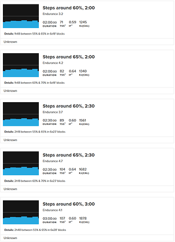

Is anyone else interested in a catalogue of longer, lower-intensity, custom endurance workouts? I don’t see a lot in the official workout catalogue over two hours that tops out at 70% or less, except of course for workouts shaped like Richtmyer that would sometimes benefit from having a higher floor.
I‘m happy to make a group and share mine, althoug I won‘t get to it today or tonorrow…

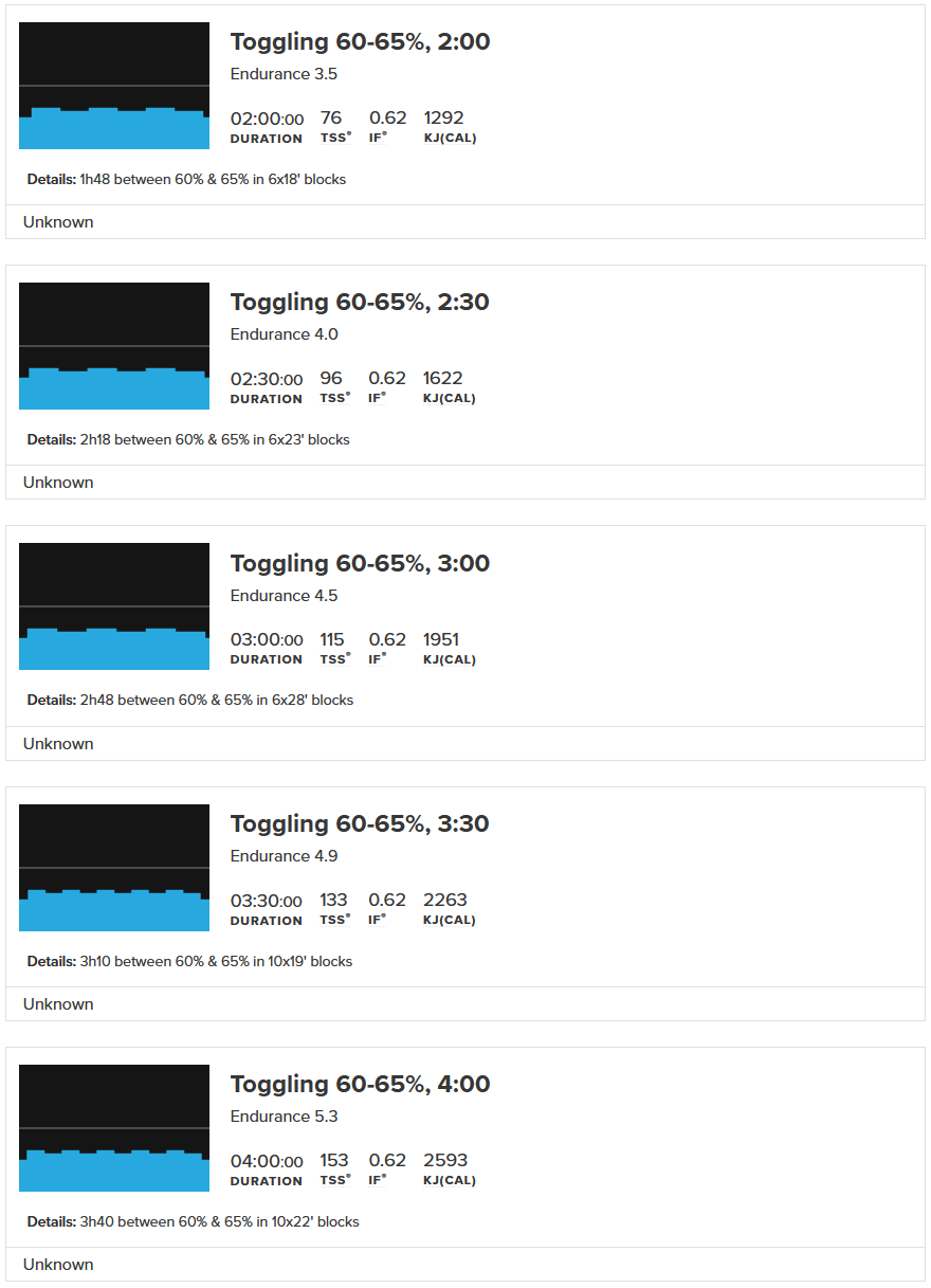

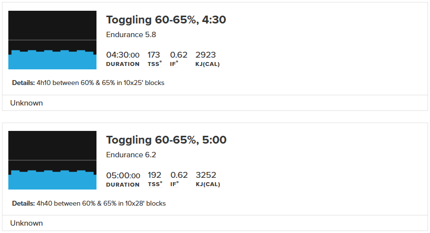

Just did some stuffing around in workout creator.
Can go lower intensity. Gauging interest first.
FWIW, PLs seem to be within about 0.3 of what’s comparable in the TR catalogue, so not too far off.

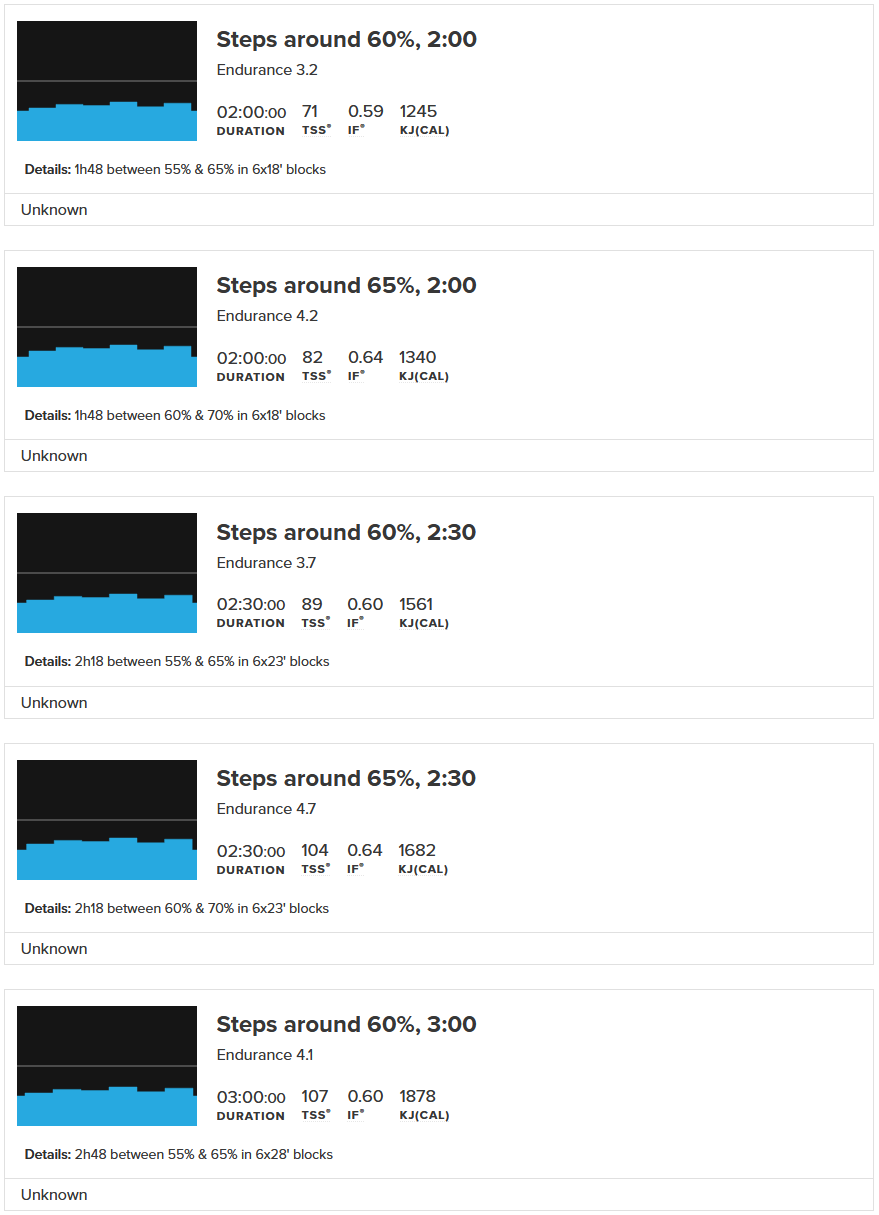

The “steps” workouts have differing but steady targets within a 10% window
Shorter workouts using 6 blocks are -5%, +1%, -1%, +5%, -3%, +3%… that is, % of FTP over or under the midpoint in the workout title.
Longer workouts using 10 blocks are -5%, +1%, -3%, +3%, -1%, +5%, -2%, +4%, -4%, +2%.
All targets are held for the same duration within each workout.
Wondering if the power target distribution needs to be tighter. :thinking:

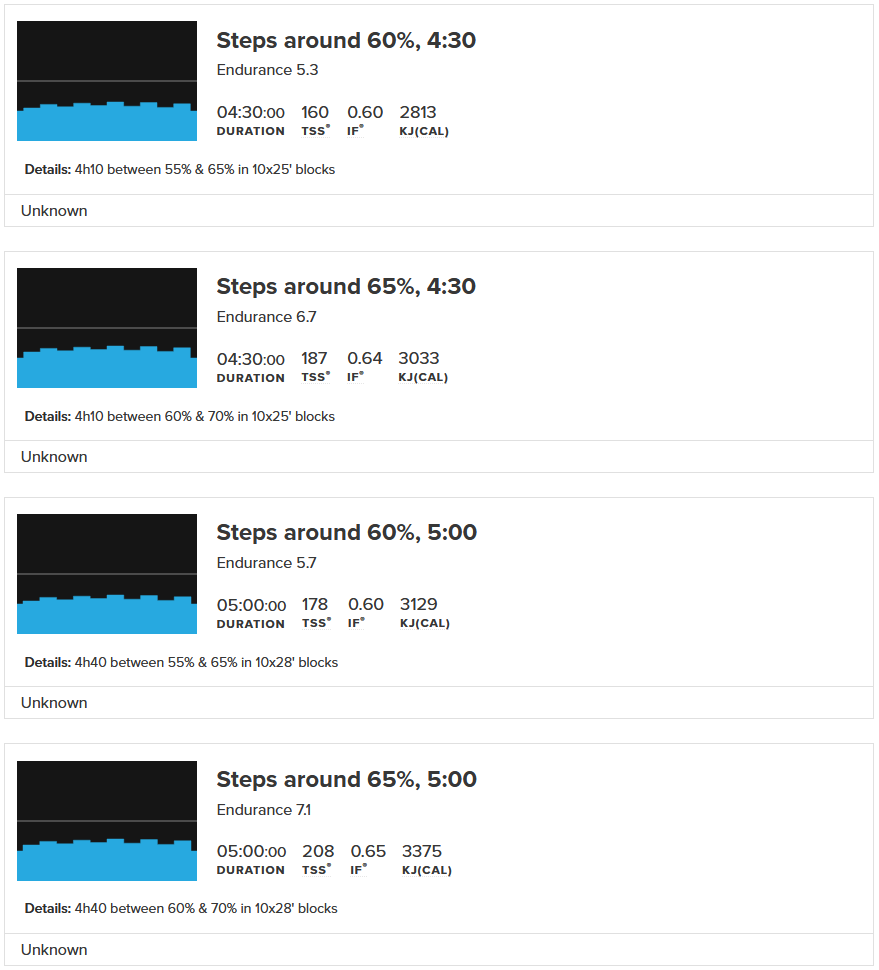

Then these that are easily memorised for doing outside. Two targets, all held for the same duration, 3 or 5 times each. Do workout, associate with the indoor calendar item.
Not really sure who’s mad enough to ride outside for 5 hours without a pee break, water refill, or coffee stop, let alone freewheeling, but hey… :person_shrugging:
There we go, 15’ provided to take care of such needs…
(I’d question its PL though… probably needs to be lower.)
Any thoughts?
