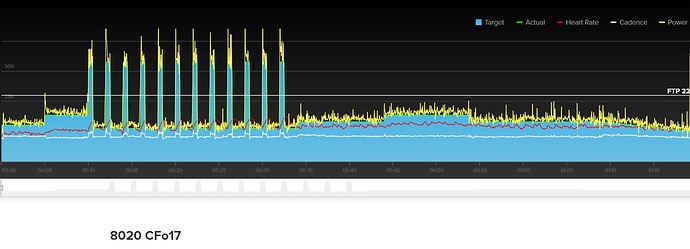

Original author mentioned Matt Fitzgerald’s 80/20 plan which from my perspective is quite different to Seiler’s approach in his studies. If you look at IM plans you will find a lot of workouts (I would say majority of hard workouts) in Zone 3 of 5 zone model. That are intervals targeting 91-100% of FTP. Only couple remaining workouts are targeted in Z4 (102-110% FTP) or even Z5 (above 110% FTP).
Ive created a lot of the Matt F 80/20 plans for TR and do them quite often.
:slight_smile:
Nice, just one note. Those Z5 efforts should have been done with low cadence in CFo workouts. :slight_smile: The purpose of those intervals is high torque low cadence strength work. At least that what I’ve read in the guide book for Matt’s workouts.
Hi gtom, Thanks for the feedback :slight_smile:
Is this your high intensity or low intensity workout? :thinking:
This should be counted as a high intensity workout - the 20% is sessions, not time, this is a good example of that.
