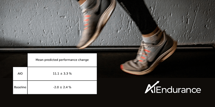

Hard pass. Just using science and AI means nothing. In sports science there’s gobs of contradictory results. There’s also many things confounding factors outside of the data collected. So let’s take a look at the details.
I found this page, then fell off my chair laughing.
They trained AI on a small sample (126 runners, cyclists and triathletes) historical training data and looked at what TID they had that had better performance gains. Then categorized each athlete as better at a certain TID type and simulated all their training like that. All of their conclusions are based on simulations, not actual training according to their plans. Also, their simulations of these athletes continuing to do what they have done almost all predicted the athletes losing performance, despite not changing their training. So their hypothetical simulated gains are all measured compared to a negative baseline! They also are only looking at 8 weeks from now. There were no longer simulations.

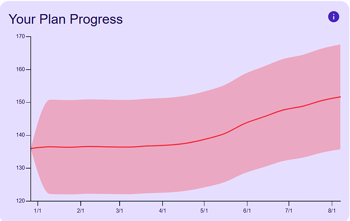

I have been using AI Endurance lately and am impressed with it. While it uses AI to create a training plan (similar to TR), the main attraction is around the use of RHR and HRV data, both overnight data from your watch as well as in-activity data captured using your Garmin Edge.
So it can give you RL/GL type of recommendation based on RHR and HRV instead of just past workouts, which I think is what TR does.
Unlike TR it can also predict your future fitness level. Here’s the prediction it gives me:
