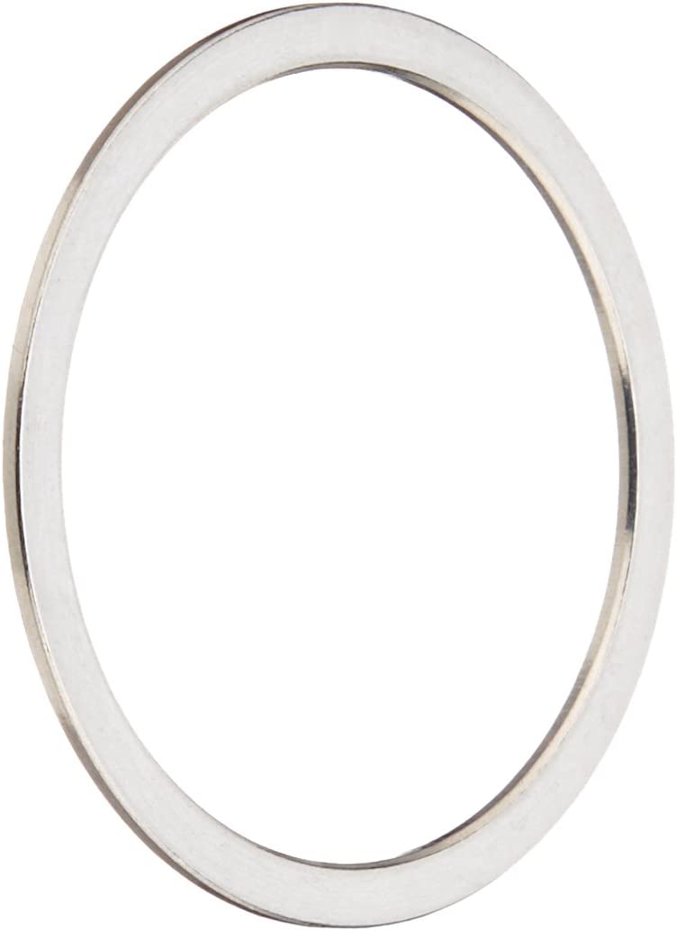

Like @MadTuna said. You can find cassette shims online so if you figure out what is the most outboard cassette and use that as your “zero point” then move the others out to meet it. A quick google found these 1mm shims. I’m sure if you looked harder you could find thinner ones (maybe even non bike specific ones).
I’ve never done this so I don’t know how far is too far to shim a cassette though. So maybe talk to your LBS about it.
Edit: From the source:
These are thinner but for bottom brackets. Though the inner diameter is 0.3mm smaller so maybe too small but OD is the same.
