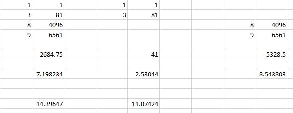

… and the more un-even the intervals are in power, the more difference we’ll see in those two calculations. These two are almost identical so the sum of two splits is almost the same as doing the math for the whole span:
vs.
vs.
Ok I’m done geeking out on this. Sorry about that ![]()
You’re correct, that was a mistake to state that. IF and TSS are functions of FTP however. It doesn’t take away from the larger point that these measures are inappropriate for this type of ride.
What makes you think that? TP gives that ride a TSS of 33, which aptly classifies it as what it was, i.e., a weak sauce recovery noodle. TR’s screwed-up calculation of a TSS of 199 doesn’t change that.
To me it looks like TSS is Ok for this type of thing, even though overall it seems too simple of a model to really have any real accuracy. Sure the training load is non linear with power, but assigning a certain fixed scale that is supposed to work the same for everybody seems rather optimistic. But hey, it’s simple and it’s something everyone seems to agree on.
If I was trying to go for some serious high intensity intervals going after my coffee, then TSS would potentially become very inaccurate by the nature of the formula plus given that the top end power doesn’t correlate so well with FTP.
Makes me think that TSS would be quite a dodgy number to go by for say a training mountain bike ride in the park using technical trails where power would be super choppy, almost like doing high intensity intervals.
Don’t people use NP from crits to estimate FTP? How is that any different?

@old_but_not_dead_yet TR TSS was 55, so it’s off but not 199 off.
@RLucky82 no point in trying again, it is pretty clear where the issue is from looking at the same ride split in two.
@RobertK, imagine a grand fondo ride where you hit lap button like I did every time you atop at aid stations. If the gap like that indeed creates a skew in TSS, you’ll get somewhat incorrect (higher) TSS for your overall fondo depending on how much time you spent at aid stations.
