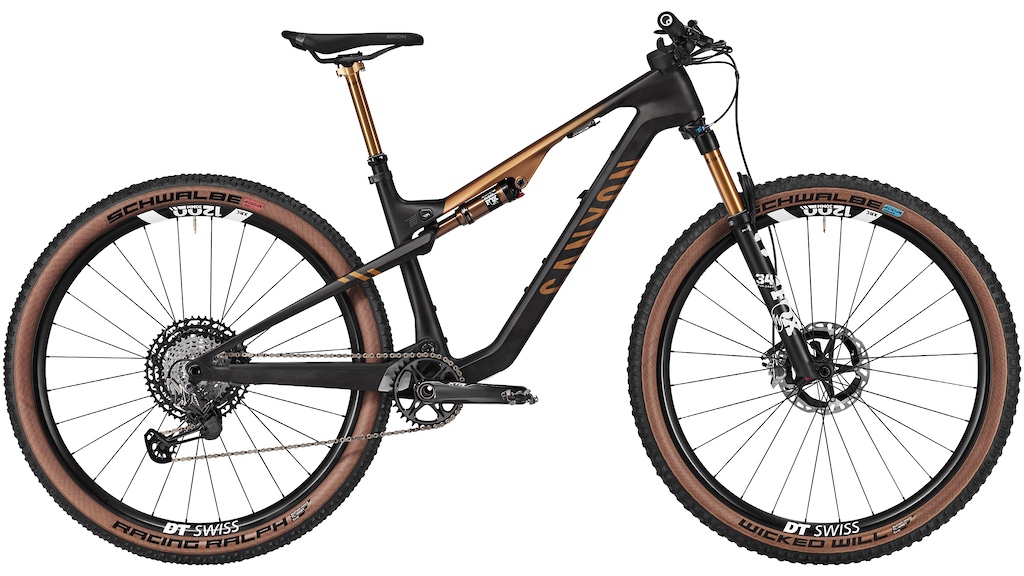

I really like the Top Tier XTR/Fox Factory build. Kinda crazy that it’s also under $7k.
Still not a fan of headset routing, but I could live with it at that price/build level.
Geometry looks a lot better - similar to my 120mm fm936 which rides brilliantly. Love the internal storage department
I don’t think we can get that in the us unfortunately and our options are like 27# without pedals. And headset routing. Otherwise it looks pretty nice.
