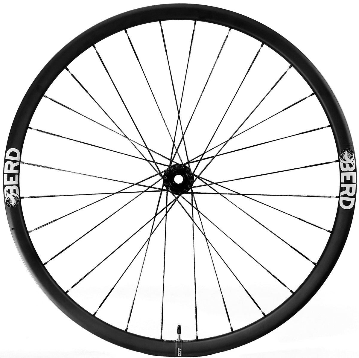

Take a look at Berd. I had the wheels on my rigid bike relaced with their spokes, and I really liked the change along with the weight loss. I also just had another set of enve m635 relaced and I dropped over 100g going from cxray to berd. I mostly notice an increase in corner traction and a little more control on choppy downhills.
I ended up getting the crest cb7s with aerolite spokes and torch hubs. Very quick set of wheels and surprisingly they ride really comfortably.
I’ve got two sets of wheels for my xc bike. one is all berd with i9 hubs. Really wanted the enve rims, but couldn’t hack the price tag. The Berd rims come with a 3 year warranty and I had to make a claim before i ever even got them on the road. No questions asked replacement. very pleased so far. but, only have 100-150 miles of dirt on them so far.

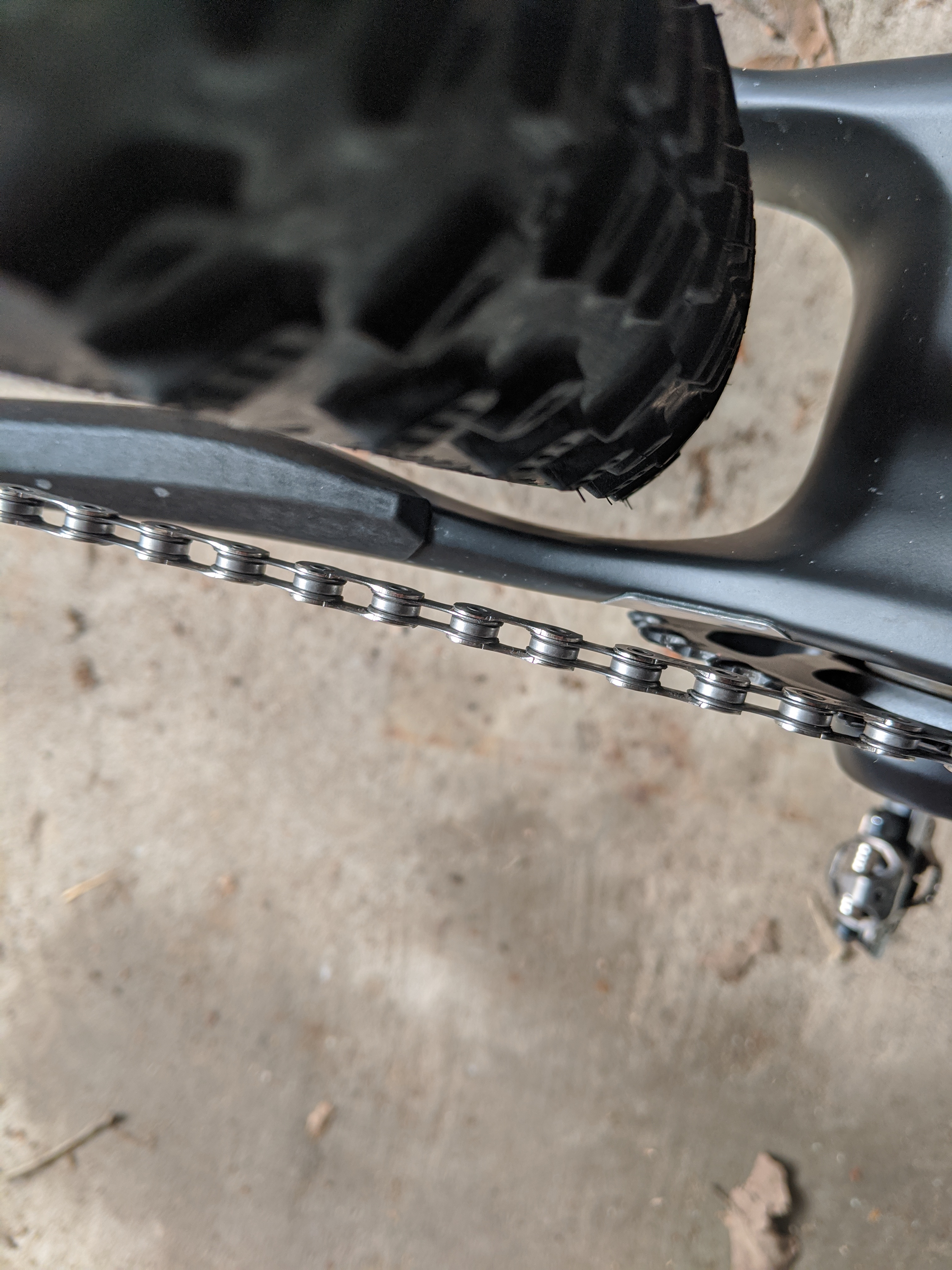

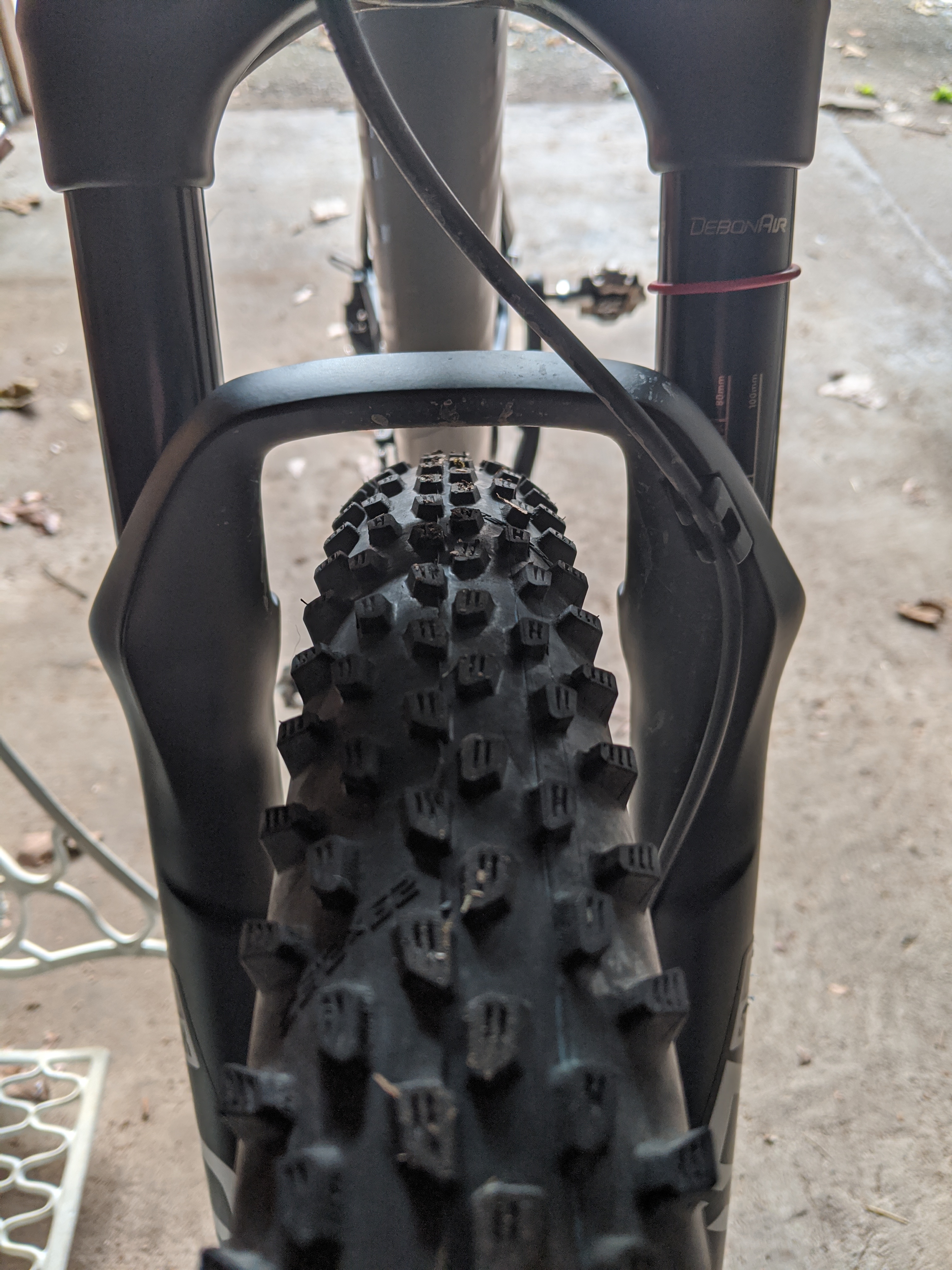

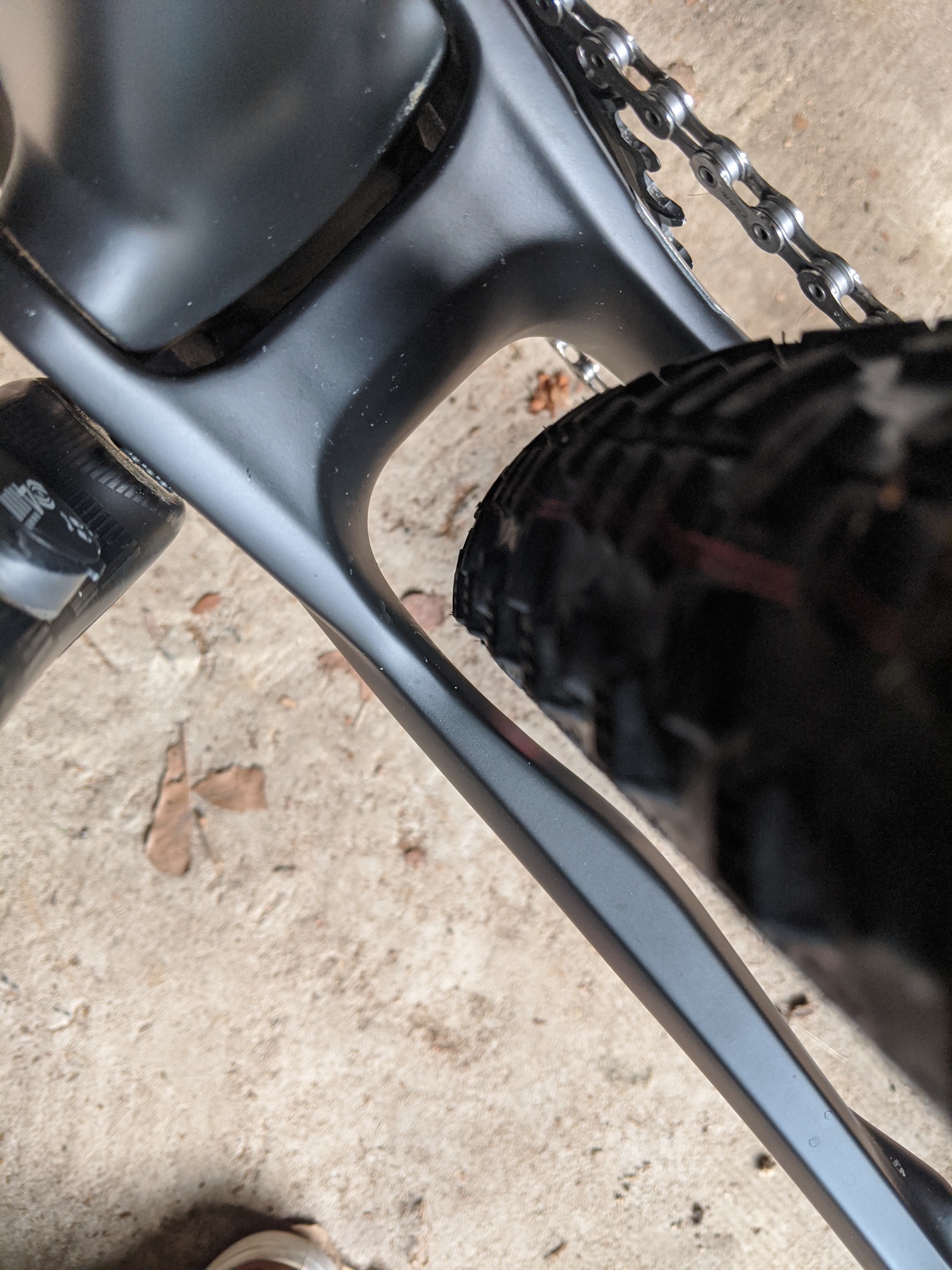

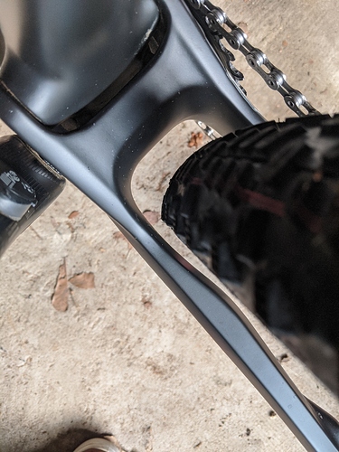

Do you have sufficient tire clearance with 2.35 and Lux frame?

It looks tight but there is at least 1 cm all the way around. Here in Arkansas, we get mostly sandy/watery mud that doesn’t stick too hard, so it hasn’t been a concern. For me, tire clearance is definitely sufficient.
