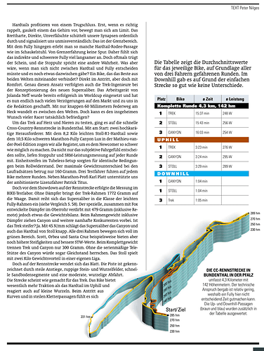

2020 Trek Supercaliber XC MTB Race Bike
anyone have the cliff notes to this in english?
if you download the picture and put into Google translate as a picture, it will translate it
