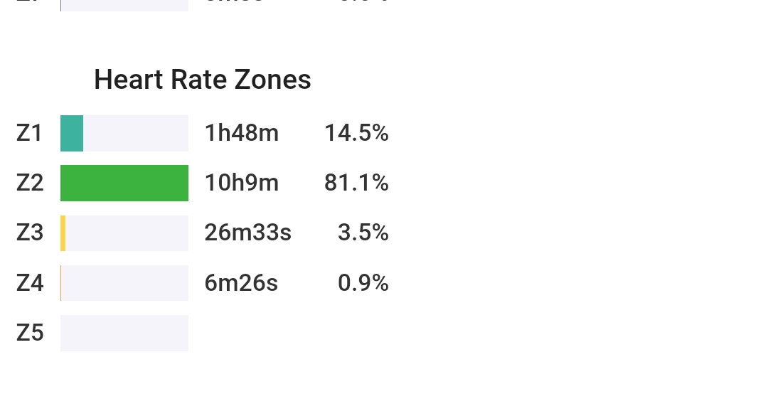

New screenshot with my updated powerzones in intervals.icu
Z2 = Endurance
Z3 = Endurance (LT1)
Z4 = Tempo
Second week done. 14h30.
mostly endurance but had to do the ZRL Cobbled Climbs so that was pretty intensive ;-).
Z2 = Endurance
Z3 = Endurance+
