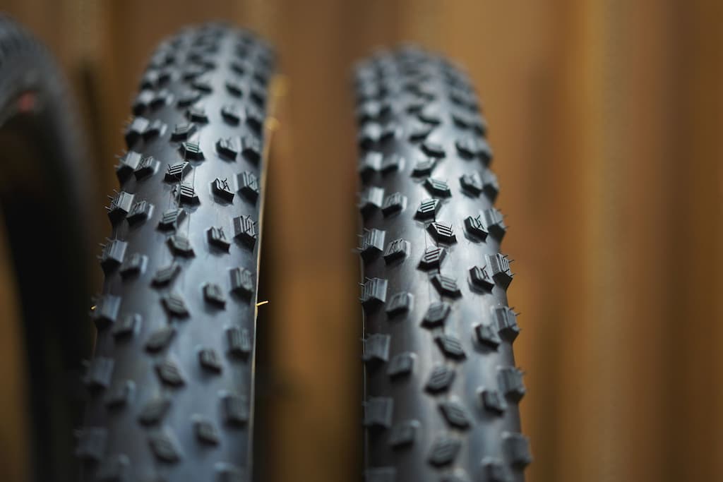

Rick XC 2,4 vs. Dubnital Race 2,4… both super fast, some prefer grip of Ricks, others prefer Dubs.
But which one is more comfortable in bumpy terrain?
I don’t think either would be more or less “comfortable”, but from what I know the Rick is Marginally faster, the Dub marginally better traction and more durable.
they’re pretty similar really, or rather different approaches to a similar outcome. terrain, riding style and inflation pressure will determine which is better in what ways.
Rick has minimal center knobs and (relatively) big side knobs whereas dub is more even so rick relies on leaning it over to engage the side knobs more for grip. finding the ideal pressure will also influence that and be a big determinant in comfort - the volume difference is minimal.
puncture protection according to BRR Dub has an edge but they’re about the same thickness and Rick actually feels like it should be sturdier than Dub
