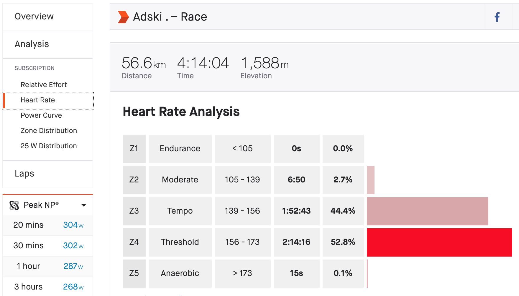

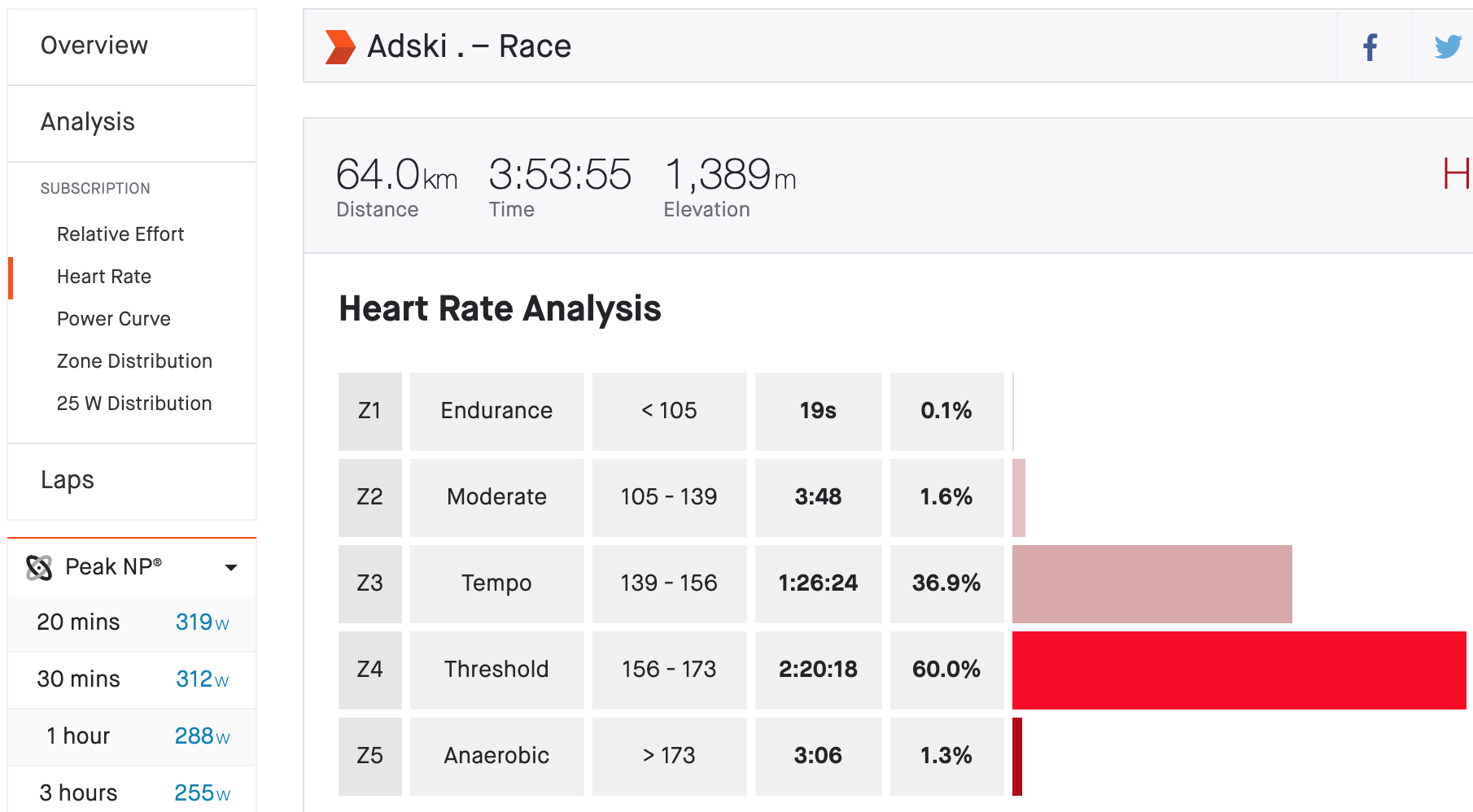

That’s a cool way to look at it, long events warrant staying under a threshold HR. That made me dig out a few examples, to contrast. Offered without comment, other that to say my HRMax is definitely accurate.
