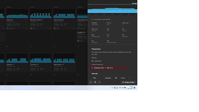

For what it’s worth, I have seen on occasion the graphic changing the progression level not always match with the progression level on my career page, and after being surprised, I’d check and my actual PL would be as expected.
/shrug
Does the chart on your “career” page show the PL being 1.2? The Progression from that workout is -3.3, but I’m not sure that reflects in your PL for AT.
working as intended?
This is what I think happened.
You had set an endurance PL of 4.5 sometime in the past - likely > 2 weeks prior to Fletcher being completed. In the meantime your endurance PL had been slowly decreasing. However, because you hadn’t done any workouts that directly impacted your endurance PL it was still displaying as 4.5. Thus, at the time you completed Fletcher your endurance PL was some other value - likely 3.3 based on that screenshot
Thus, when you completed Fletcher, it forced a recalculation of your endurance PL and it was set to 4.1.
The flaw that I think you’ve hit upon is that PLs don’t update in real-time as they decay. They are only recalculated when you do a ride that touches on that PL (either as the primary or a secondary PL).
Therefore this appears to you as if riding Fletcher decreased your endurance PL, when really all it did was recalculate it based on what the system views as your current capabilities.
If TR recalculated all PLs on a nightly job for all users you’d likely have seen your endurance PL slowly decay in the interim from your prior 4.5 endurance level to something at 4.1 or below
“considering just ditching AT at this point”,- already done this, the PLs and reduction in PL and ‘workout adjustments’ I ignore and just choose the PL/TSS/IF I want.
Thanks for bringing this up! Upon looking more closely at your PLs and completed rides, it looks like there’s an initial bug in that calendar ‘celebration’ display. We’ve created an issue for the team to fix it, but as you can probably see from your now correct career page: once the ride syncs (or the full app resyncs), the numbers should update correctly, so you may see this only immediately after workout completion. We’ll get going on this fix!
