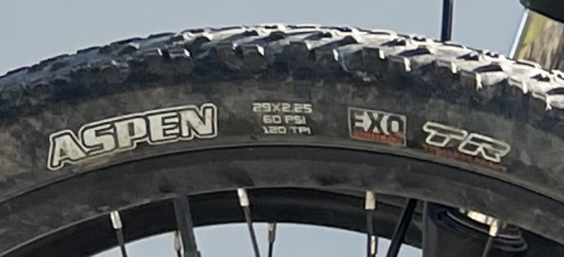

Tires on Scale: Maxxis Aspen 2.25 → Spark: Maxxis Recon Race 2.4

I don’t have other tires available at the moment. So I couldn’t test this yet. But it would surprise me if the Aspen 2.25 are that much faster than the Recon race 2.4 on a gravel climb!?
