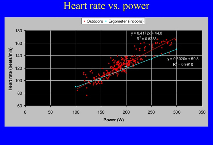

This graph in a presentation by Coggan from 20 years ago seems to describe the OP’s situation. He credited the difference between indoors and outdoors as being partially due to distribution of power output.
